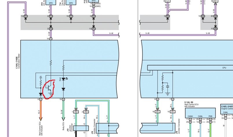

    SPD Signals are the same In and Out
    Makes you wonder why they used the Combination Meter as a bridge to the ECM?

    IDK, on the 14 diagram it shows a transistor in the Combination Meter that generates the SPD signal.

    Well, it must be generating a duplicate signal?
    Because they look the same to me:rofl:

    @Dm93 has a manual iirc? I don't think there is any conversion of the speed signal in those trucks. It comes right off No1 Vehicle Speed sensor as a pulsed waveform. In auto trucks the Skid Control ECU takes one of the rear ABS sensor signals and coverts it to a pulsed signal, assume similar to what is shown in the scope grab. The Combination Meter just cleans the signal and passes it along to the other components that need it. Apparently there isn't much 'cleaning' needed though haha

    2012-15 trucks are different, they get it from the ABS ECU on both auto and manual trucks.

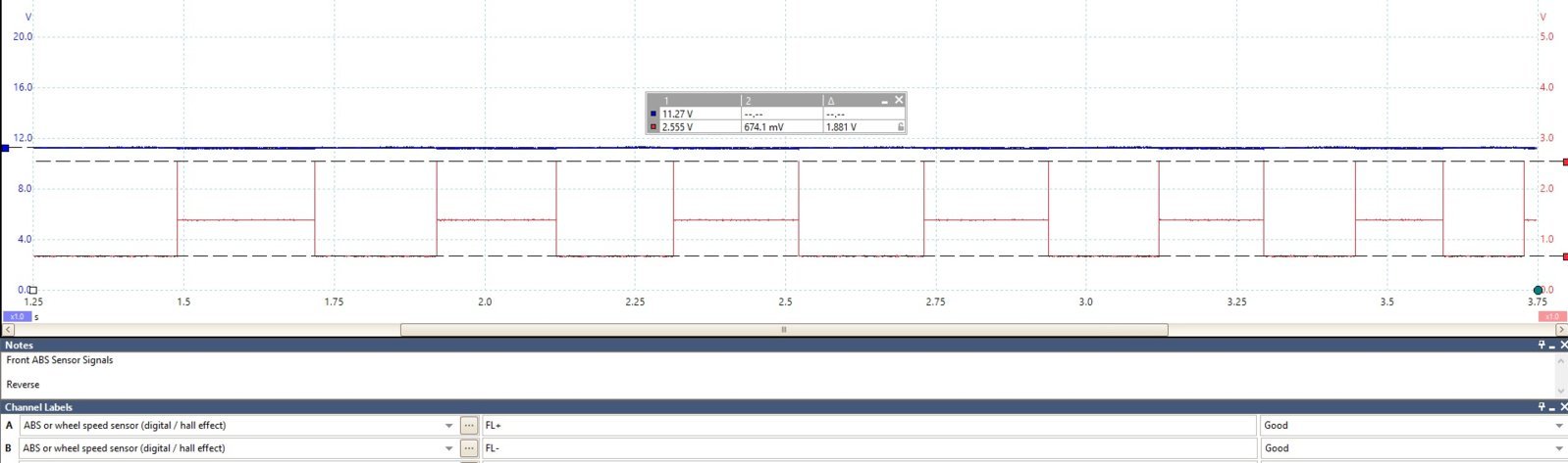

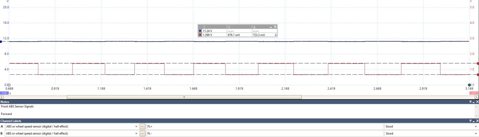

    Just did captures of the ABS Sensor signals, now we know how the ABS module knows which direction the wheel is turning. The ABS sensors are "smart", they internally use the magnetic sequence of the tone wheel in the bearing to determine the direction of rotation and output a different signal pattern for reverse rotation.
    As you can see forward rotation produces a normal square wave.
    Reverse rotation it adds a very short (< 100 µs) ~1v pulse to the rising and falling edge of the square wave.
