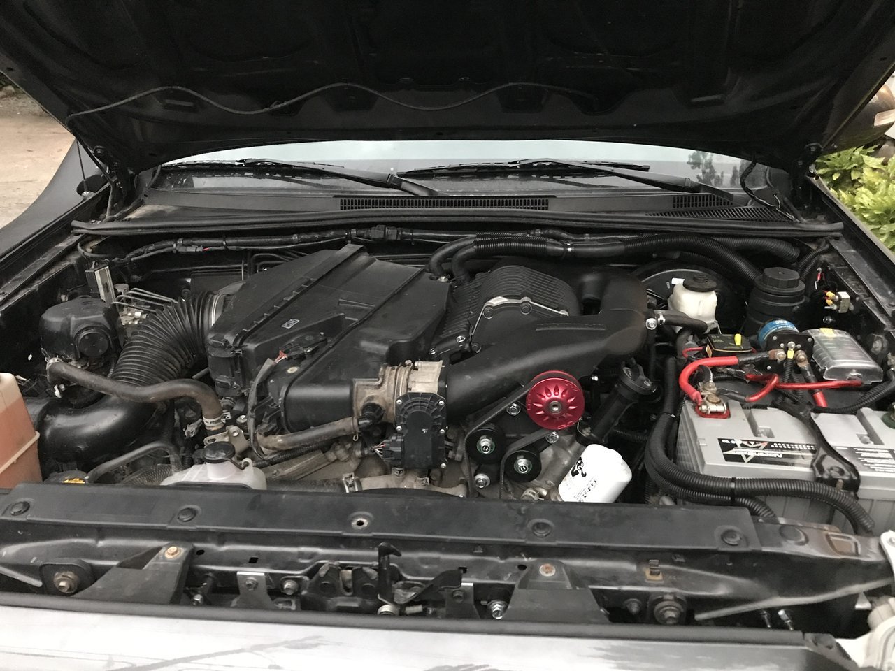

    I have the Magnuson supercharger, 2.85 pulley, Ucon stage 2 with exhaust cam gears. 9.8 lbs is the most I’ve seen on the gauge. It saves peak boost. That was at 17* below zero up in NH though. Normally, it’s mid to high 8s.
    I also did DT long tubes, DT Y-pipe, URD 3” cat-back, and high volume fuel pump.
