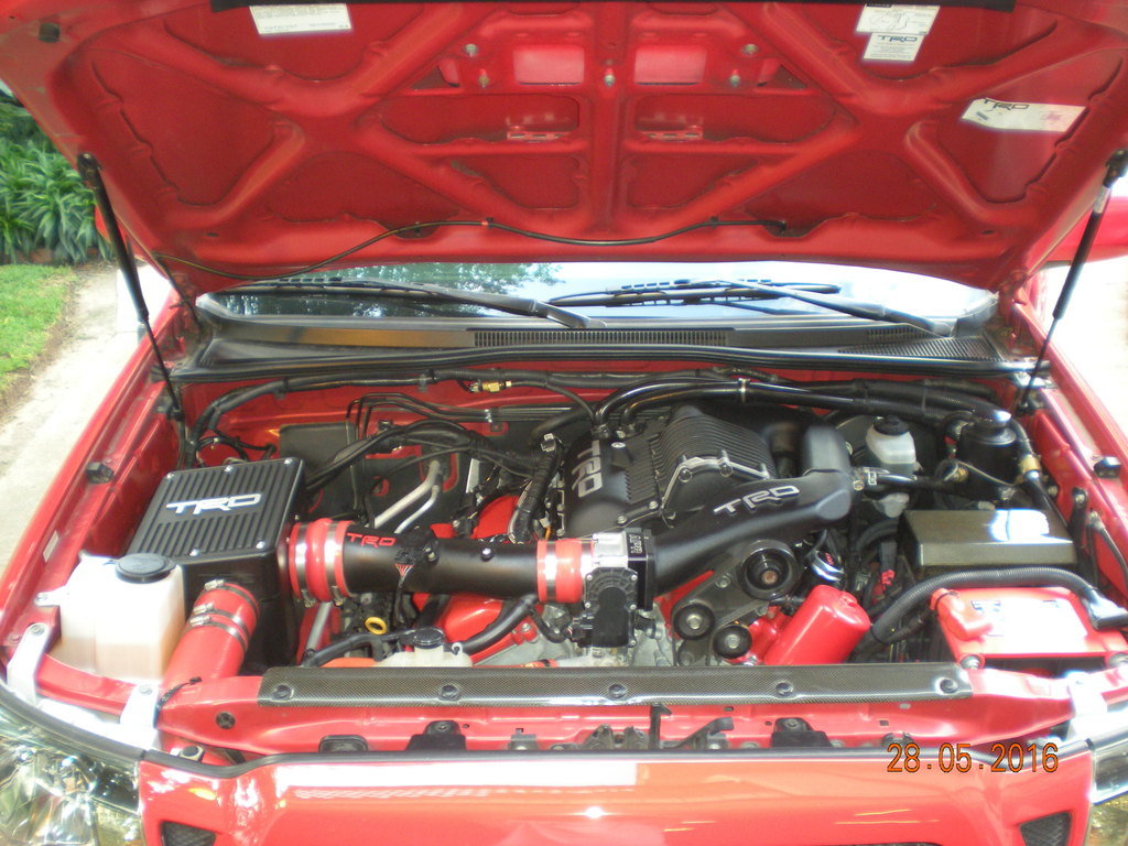

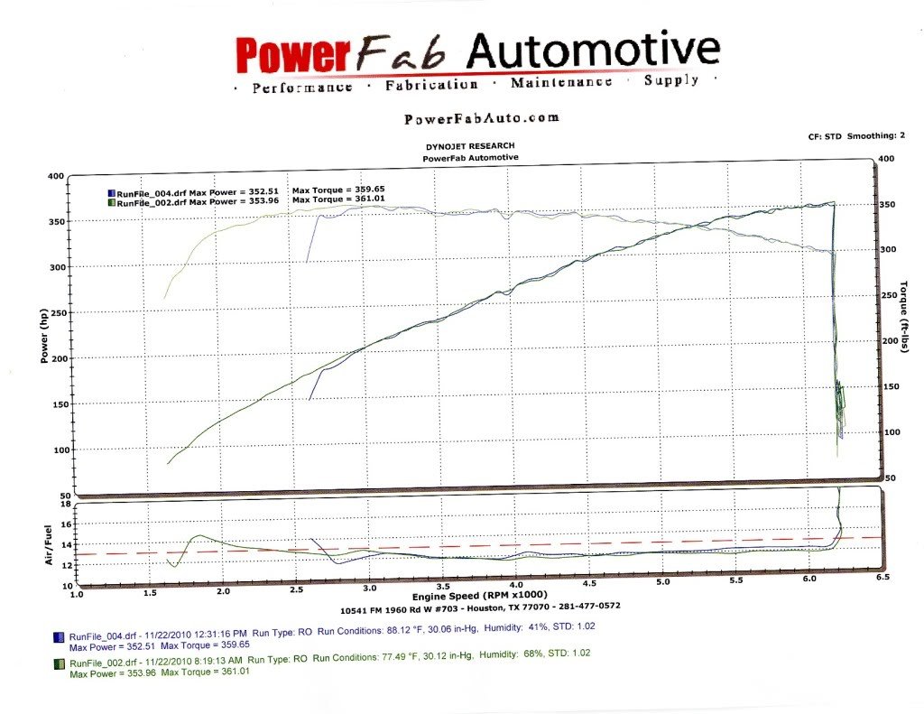

    Stock engine with a TRD S/C with add about 50 hp.
    Add long tubes, CAI, smaller pulley, aftermarket tuner (URD is working on one for a 2009) and 7th inj, URD Fuel Pump upgrade you can get close to 100 hp.
    You could go with an URD S/C and get more power.
    I have the TRD S/C and have had good luck with it.
    I have DTLT, APR ECU & 7th Inj, NST S/C pulley, URD Fuel pump upgrade, APR Y pipe and URD 3" cat back. I did the install and is pretty straightforward.
