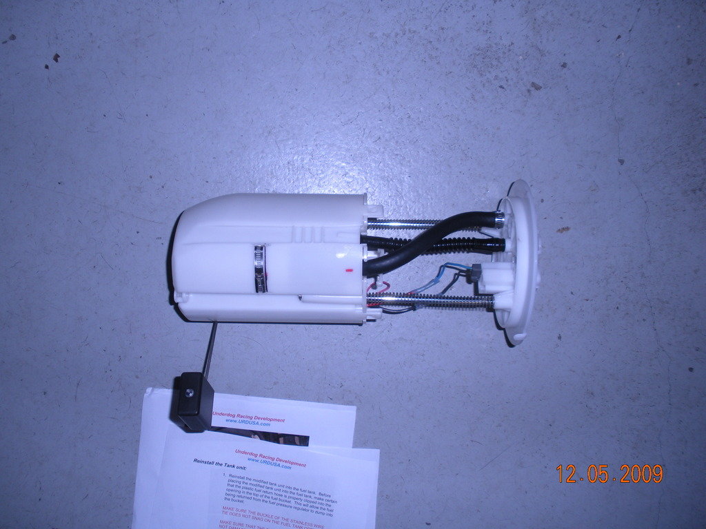

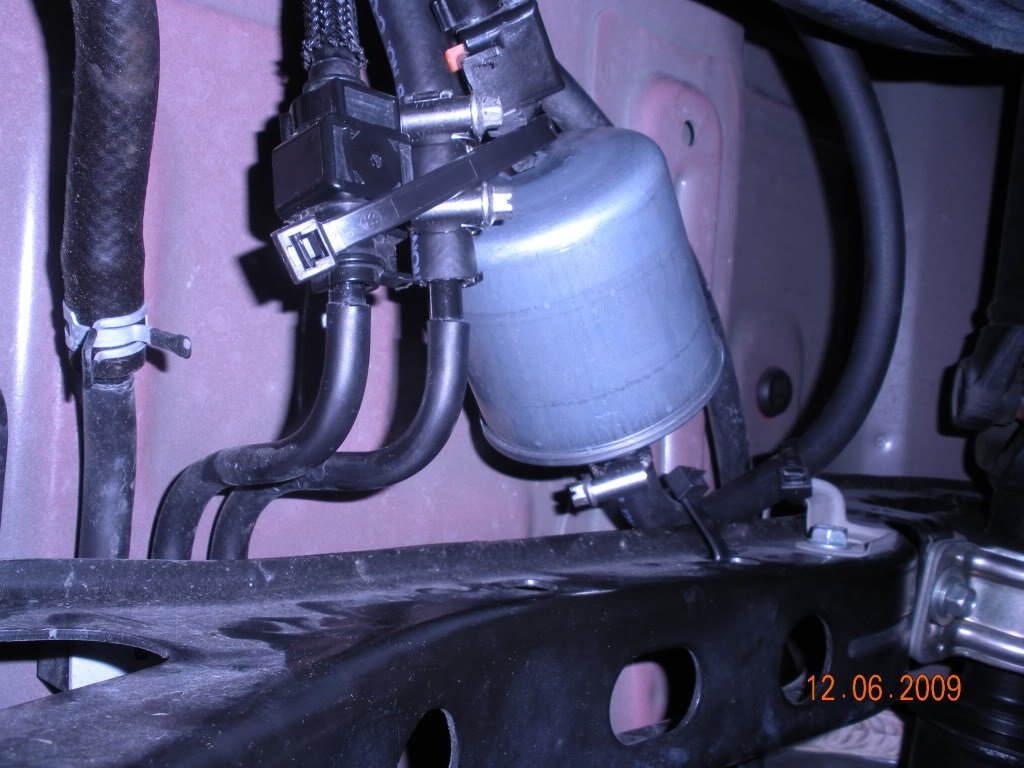

    The URD comes with a sock filter inside of the tank and an external filter.
    Inside the fuel pump cavity.
    External fuel filter (under the cab).

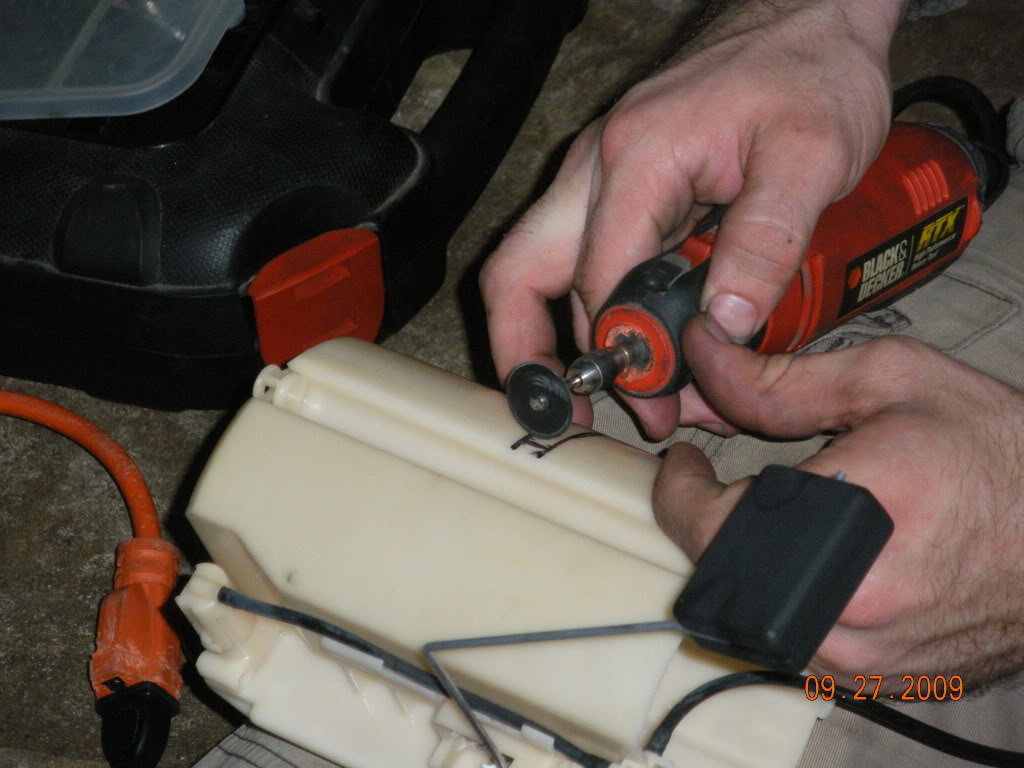

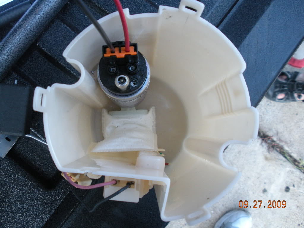

    You have to cut two little slits the the plastic bowl to accept a hose clamp to secure the new fuel pump motor. Most people use a dremel tool for this. I used an xacto knife and used a torch to get the blade hot. Once hot, the blade cut the bowl easily. I had a little better control with this method over the dremel method. of course, you are dealing with gasoline, so the bowl should be free of gas before attempting this.
    Dremel method

    Here is an exterior pic of the fuel pump. You can see the ss hose clamp that holds the motor in place.
