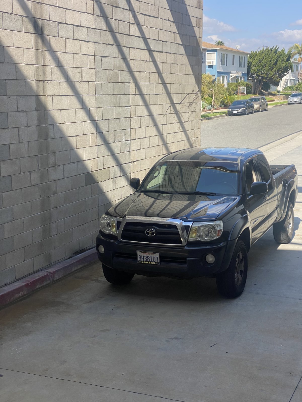

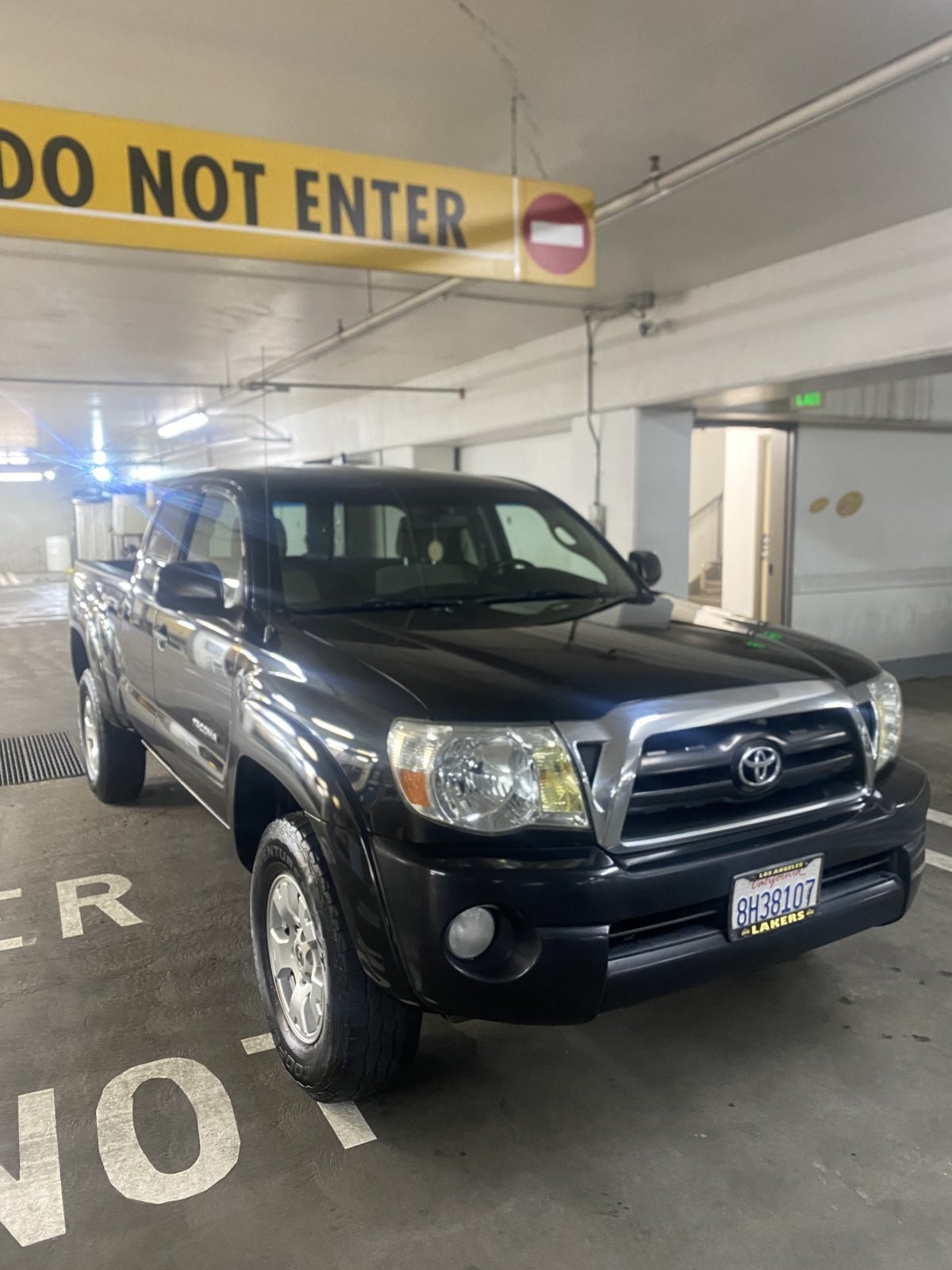

    I bought a high miles 2007 Access cab (4.0L V6) 4 months ago and I absolutely love it. Bought it with 256k miles and I am currently at 264k miles. When doing an oil change yesterday, I noticed dipstick marked level at half way between low and high marks. I have done two oil changes and have used mobile 1 full synthetic 5w30. I brought up oil consumption to my mechanic and he suggested to get a low miles 1GRFE and replace current engine but it sounds like a small fortune to me. I have replaced spark plugs, PCV valve and serpentine belt. No engine codes and although a loud engine, no weird sounds or noises. Could this be worn out rings? Any alternatives to stop oil consumption? I changed oil at a 5400 mile interval from last time. Carfax shows it’s a CA car and regular maintenance throughout its life. Also, I’m planning to keep this truck for a long time. Thank you guys in advance. Here’s some photos after washing her at 264k miles

    Nice truck what color is that?
    Considering that after 5000 miles your oil is in the safe range it seems okay and it definitely isn’t worth replacing the whole engine. Burning about 1/2 quart of oil at 250k+ I would think to be pretty normal. anyone else skeptical of the mechanics recommendation?

    Yes exactly! I like my mechanic but I think recommending a low miles engine swap is not the move here. I’ve seen these 4.0L go the distance 400-500k. It’s black! Front bumper is faded but I’m going to repaint it. I thought about installing an ARB bull bar but it’s a pre runner not 4x4 and mostly drives on LA streets. I’m also saving up for a softtopper
