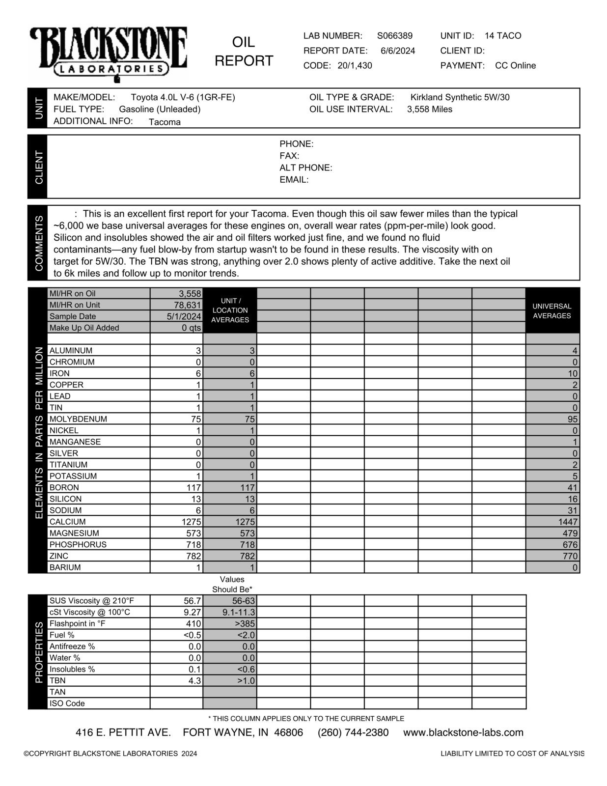

    Here's an update w/ less speculation & more data. I pulled an oil sample during last oil change (at ~3600 miles) and sent it to Blackstone Labs for analysis, including the supplemental TBN report (another $10.) Redacted all my PII using a PDF editor, that's why the name, client ID, etc. are blank.
    2014 Tacoma 4.0L V6, ~78K miles, 5W-30 Kirkland™ (COSTCO) synthetic oil
    TL;DR: an excellent oil-analysis report.
    Based on this, it looks like a 3-3.5K mile OCI is overkill and a waste of money for my particular Tacoma. I'm going to run a 5K-mile OCI & continue to send in samples to Blackstone every 20K miles or so.
    Notes:
    - Blackstone takes quite a while to process samples. About 3 weeks from the time my (tracked) sample arrived at their receiving address.
    - Report shows very low amts. of fuel-in-oil, yet I can still smell gasoline in the oil when I pull the dipstick. I guess this is just a nose-sensitivity measure since gasoline has an extreme pungency to it. The "<0.5%" measure on the report calculates out to <5 teaspoons of gasoline in 5.5 quarts (1056 teaspoons) of oil. I'm sure if I dumped a few teaspoons of gasoline in 5.5 quarts of oil & thorougly blended it, I'd be able to smell the gasoline easily.

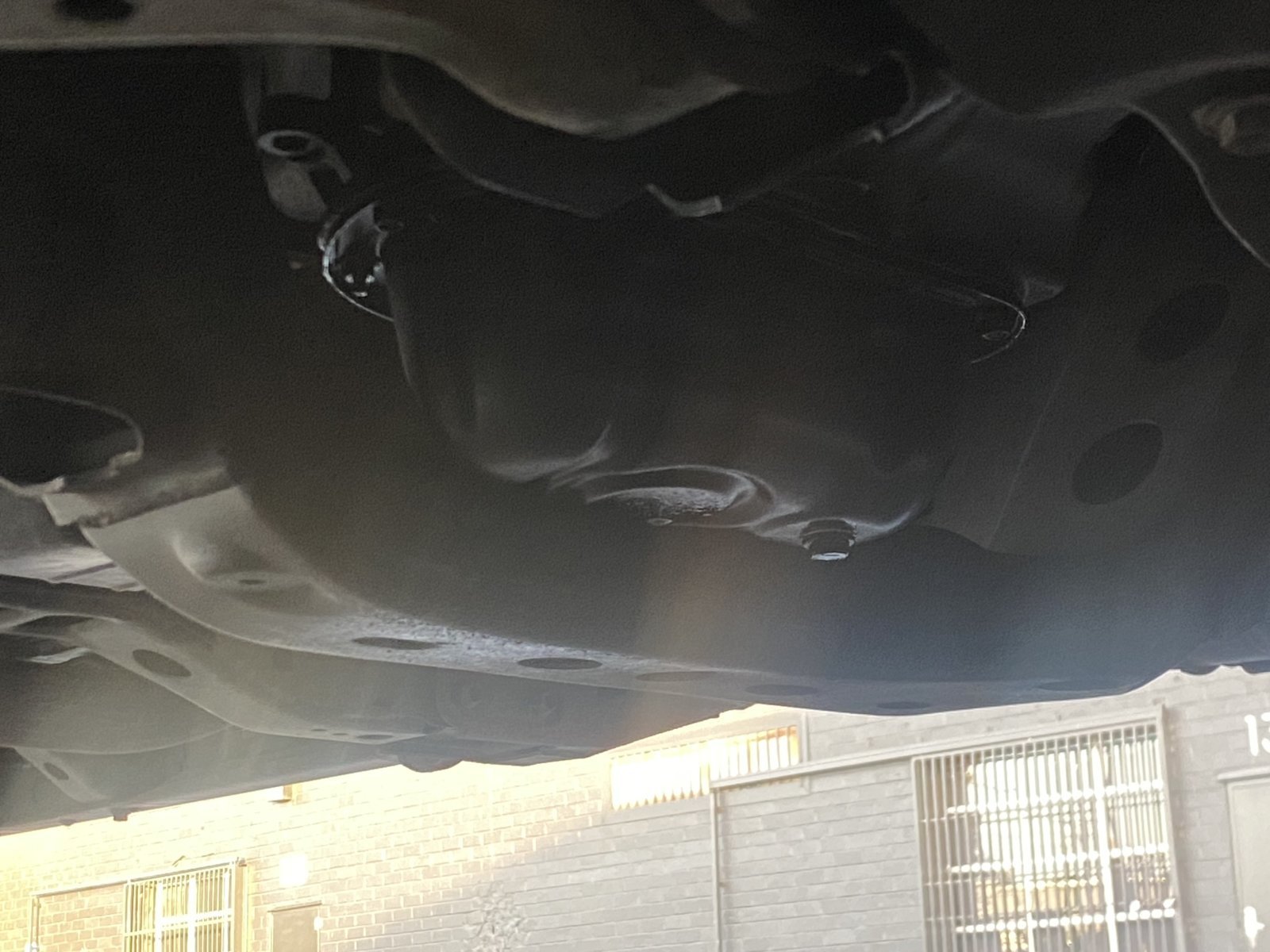

  8. Jun 7, 2024 at 8:50 AM
    #68
    2ndgenron
    2ndgenron [OP] Well-Known Member
    Jan 24, 2024
    #442355
    54
    Ron
    2nd Gen 2007 access cab
