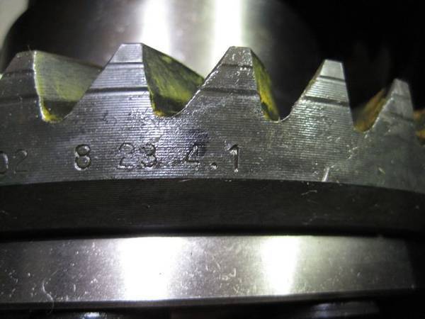

    Anything I should watch for when getting carrier from junkyard? How do I know it really has 4.10gears in it.

    gear ratio should be stamped on the edge of the ring gear
