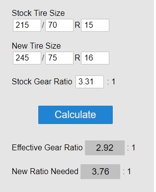

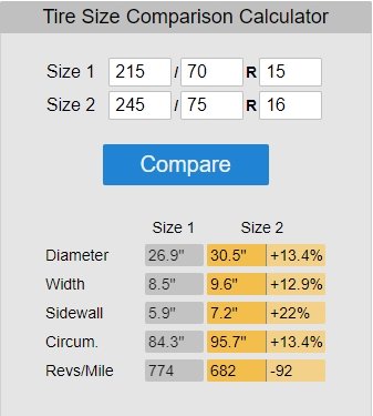

  3. Oct 31, 2017 at 4:42 AM

    See the below screen-caps that will help explain things technically.
    Unfortunately with the Manual transmission - you need to replace the complete differential with a version that has the correct gearing - the 3.31 differential is non-upgradable. A good source for replacement is taking someone's 4.10 differential from a non-TRD Tacoma, that they may have replaced with an aftermarket differential. Keep an eye on the For Sale forum here.
