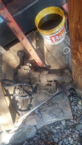

    No you will destroy your diffs when you put it into 4wd. everything needs to spin at the same speed. If you need a 4:10 front Diff I have one in my storage
