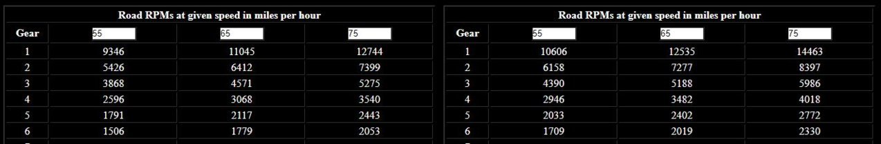

    Just looking at numbers. Stock tires 4.30's vs 4.88's. 75 is nice with the 4.30's, a bit high with the 4.88's. Obviously with a taller tire those rpm's come back down.

    You also have to factor in a 15-30% reduction in RPM when the Torque convertor locks... So it is safe to say at 70MPH with 4.30s and 32.5-34 inch tires you'll be running 1800-1900 RPMs. That should net you back to very close to stock with a tad bit of umpf for the heavier tire.

    That's why I went with 4.30's...my commute is 40mi of 75-80mph highway speeds...4.88's would have been too much gearing and killed my gas mileage.
    80mph and I run about 2100rpm, which keeps it from downshifting into 4-5th.

    these numbers are with it locked.
