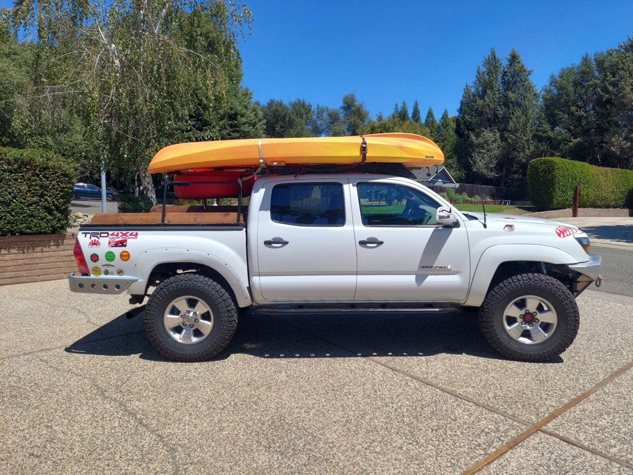

    I"M running true 35" with 456 love emm
    I do most of driving on flat land sacramento , No problem going to Tahoe , If i lived in the mountains probably would have 488 (maybe ) DCSB V6 Auto
