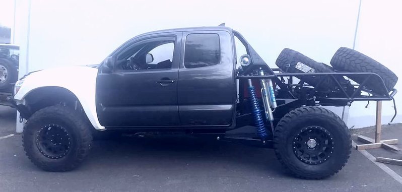

    I'm supercharged with manual transmission; 35/12.5/17s... 4.88 gears. I havnt driven the truck just yet... It's a toy, not daily driver... I can't wait to make her scream.image.jpg

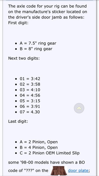

    IMG_2015.jpg I used this chart and gathered that i have stock 4.56 gears (a/tm: A04B). I plan on stepping up to 285/75/16 from 265/75/16 and was thinking I'd probably need to regear after and hadn't heard of a tacoma with stock 4.56's. Anybody know if this ratio is common on a stock '14 4.0 Auto? Oh wait just saw the bottom "'98-'00 models" maybe this chart is only for first gens?IMG_2015.jpg

    You do not have 4.56 gears. Period. Second Gens ONLY came with 3.73 gearing on all models except the 5 lugs that came with 4.10's IIRC
