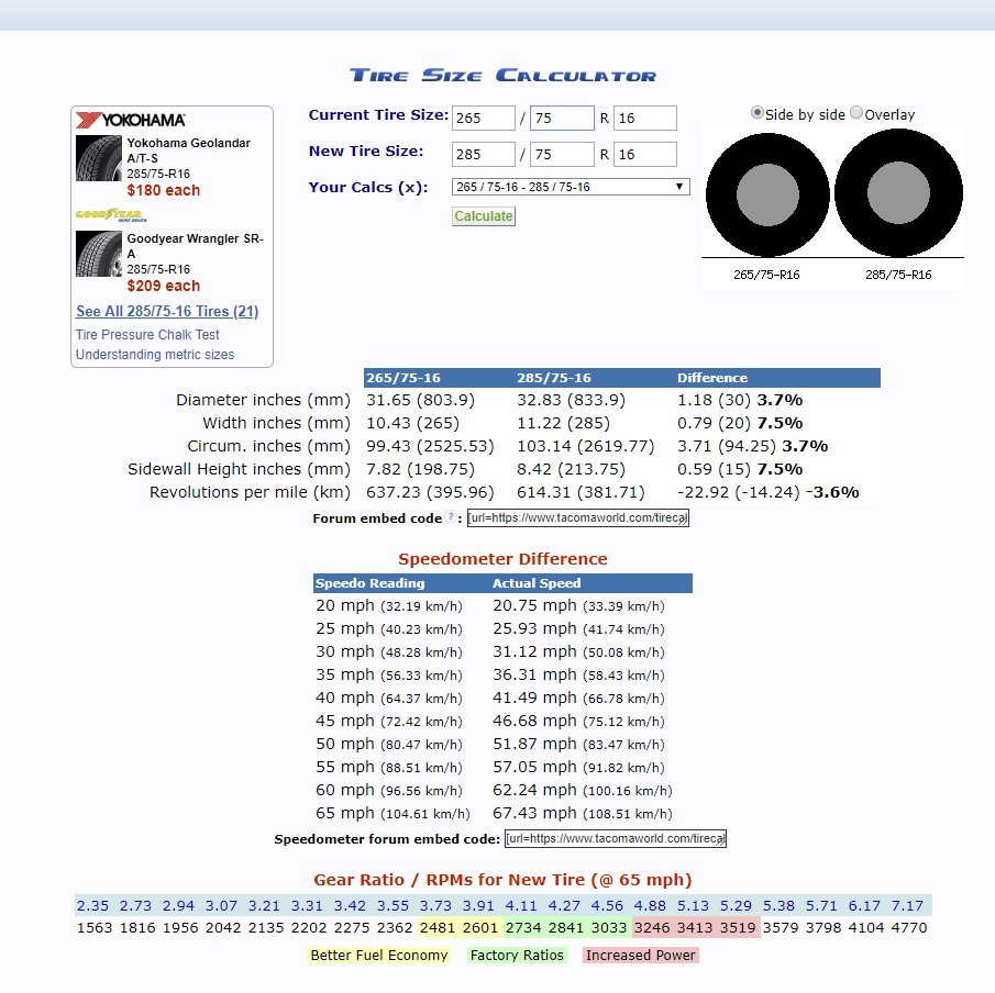

    By what the chart says, if im gonna be running 3367rpms at 65 then Ill be running close to 5000rpms at 80mph

    I don't know how accurate these charts are.
    I am running 285/75/16 with the stock 3.73 gear ratio. This chart says I should be at almost 2500 @ 65.
    Driving home on the freeway I was more around 2000 rpms @ 65.

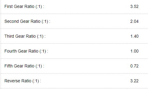

    Looks like Fifth Gear ratio on a 2013 Tacoma 4x4 Auto is 0.72:1 at the transmission?
    Honestly I don't know the math but I think I will look it up today.

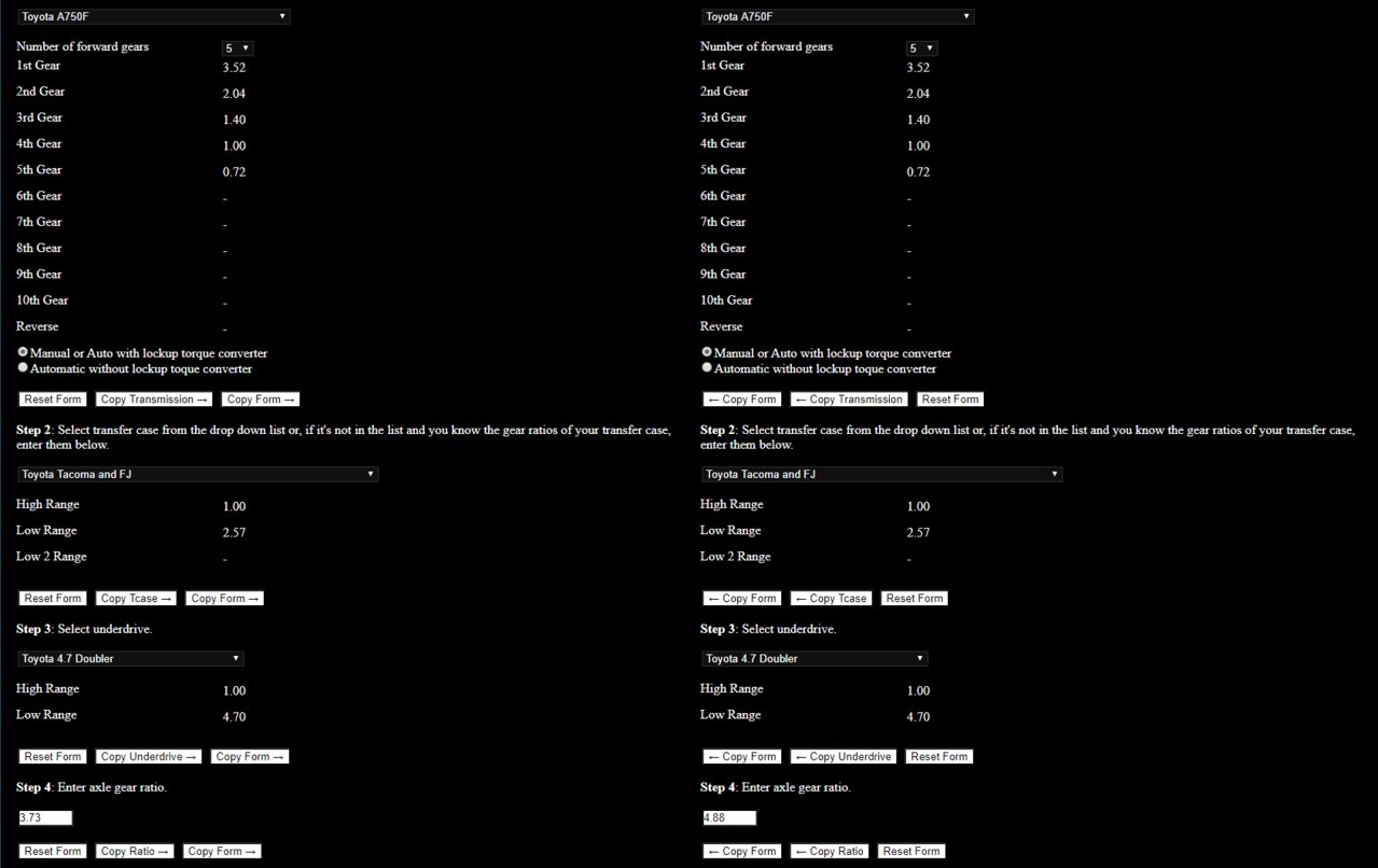

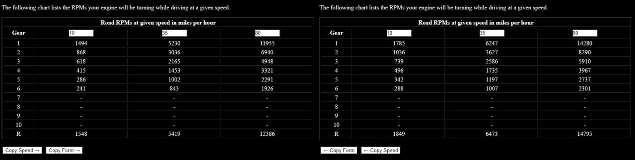

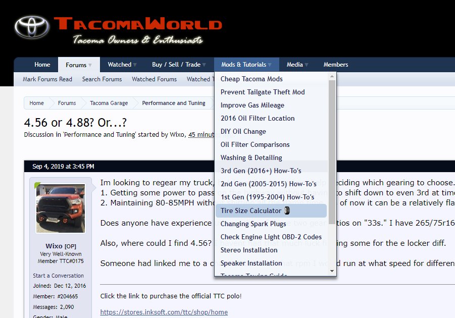

    Very cool site and easy enough to fill out.
    Ignore the fact that I added a crawl box to the config. It doesn't impact the highway driving section.
    Basically this is a 4.0 V6 with factory 3.73 gears in the rear compared to 4.88 gears running on 285/75/R16 tires.
    The very last chart is the one @Wixo is probably most interested in. It shows RPMs at 3 given speeds.

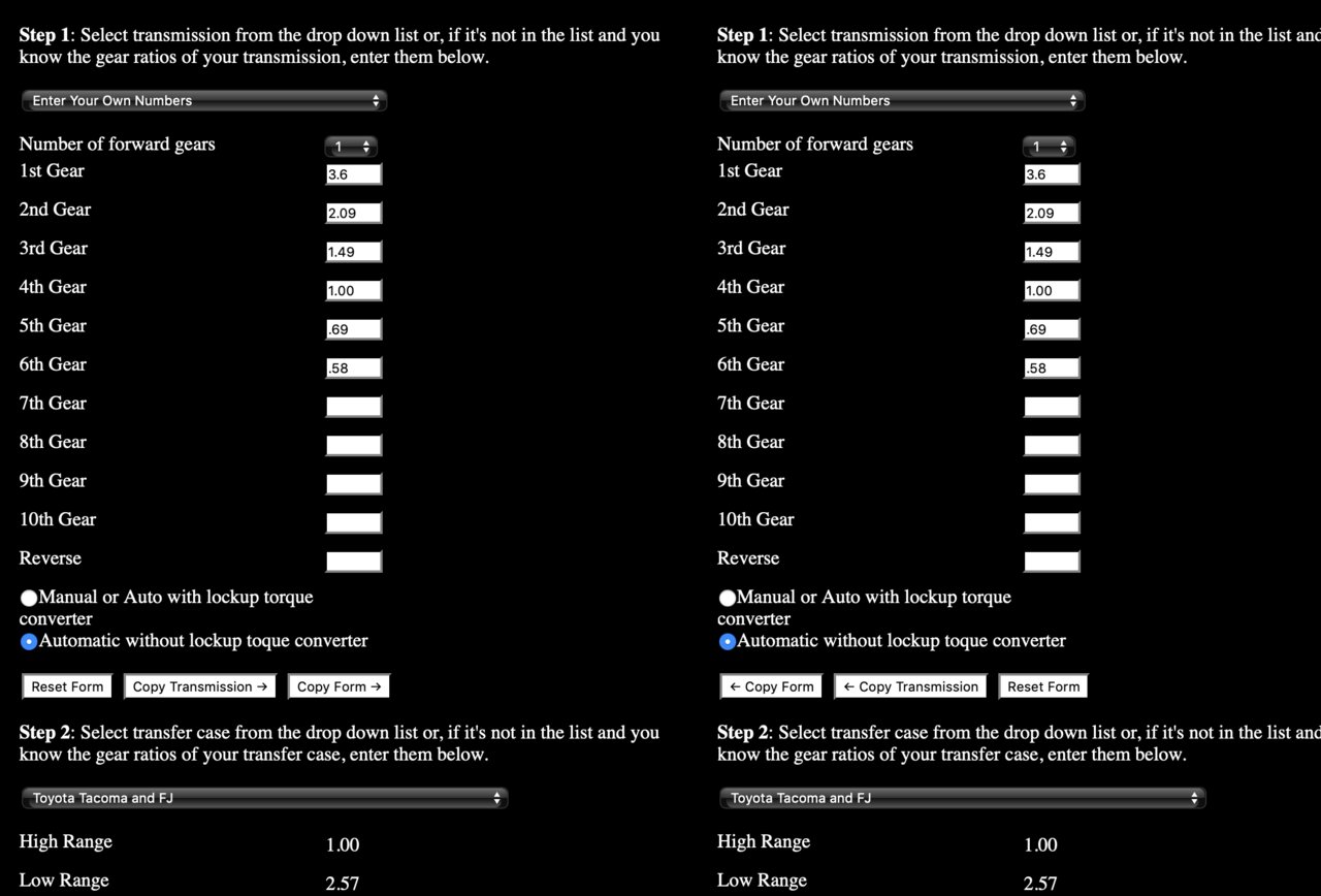

    The sticke ron my door says A/TM: B07B/AC60F Which one do I choose? The closest I found was Toyota AB60F

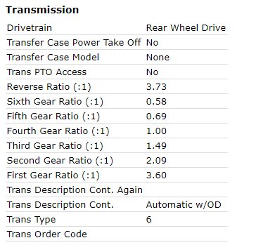

    I don't know the tranmission model in the 3rd gens but i found this and you can punch the numbers in manually.
    Found this here https://www.iseecars.com/car/2017-toyota-tacoma-specs
    Wixo[QUOTED][OP] likes this.

    @Wixo and I think your diff gears are 3.91

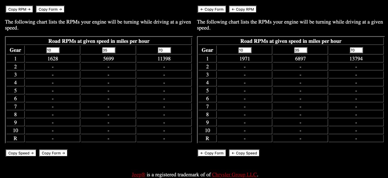

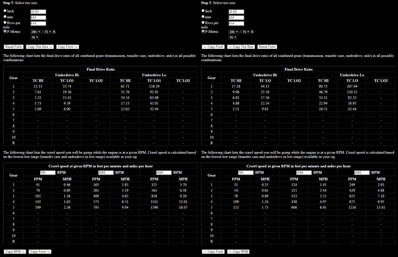

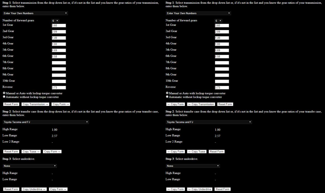

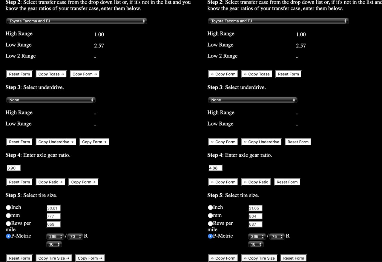

    What am I doing wrong now?

  18. Sep 5, 2019 at 12:58 PM
    #18
    Wixo
    Wixo [OP] Platinum+ Member
    Dec 12, 2016
    #204665
    4,142
    Hank
    ‘21 SR5 Tundra CM 5.7L Barcelona Red
    Tint, LED interior
    Ok I realized I left forward gears as 1. Fixed it and Im seeing that at 80, with 4.88s, Im gonna be running 2540 rpms, which really sucks for economy. Im better off with OVTune GearLock and leaving it in 5th.

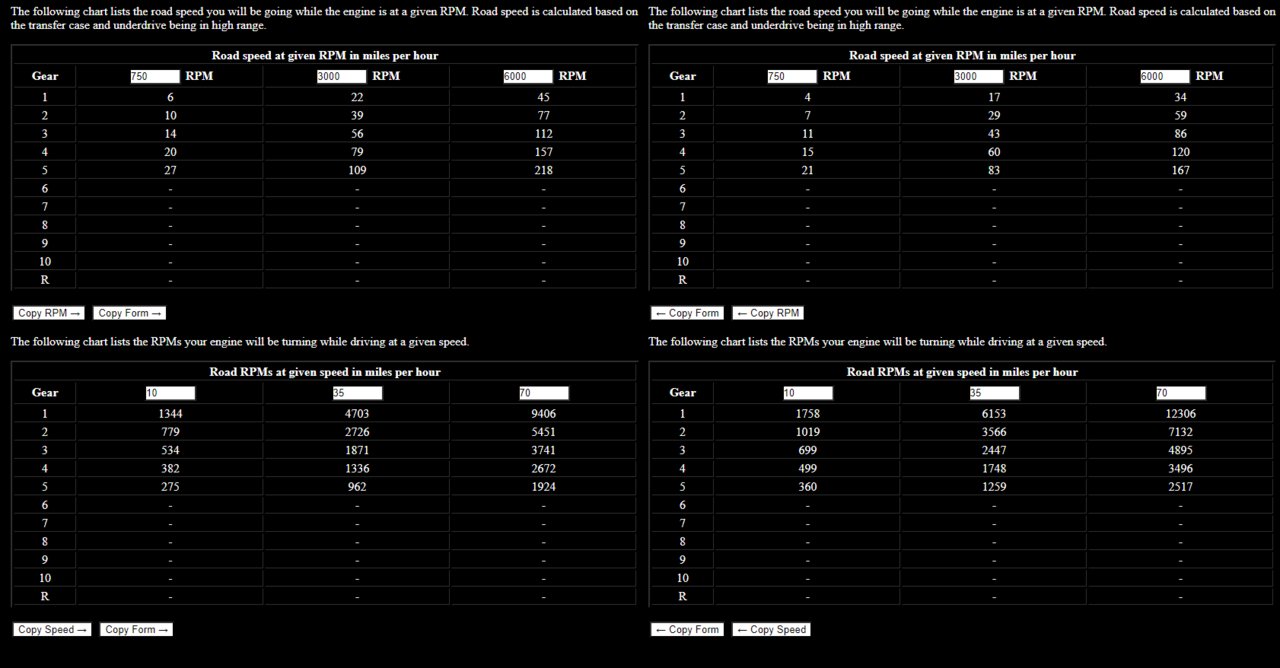

    Usually you regear because you went up in tire size and you want power back.
    Regearing won't fix the transmission software problem that seems inherent in the 3rd gens.
    If you regear and keep the stock tire size then yes your RPMs will be higher and fuel economy goes down.
    Somewhere our numbers are off as I am seeing 2540 rpms @ 80.
    Below I am using 255/85/16 which is skinner than 285/75/16 but more of a tru 33inch tire.
  20. Sep 5, 2019 at 2:39 PM
    #20
    Wixo
    Dec 12, 2016
    #204665
    4,142
    Hank
    Tint, LED interior
    Try putting in 4.88 on the left side. If I got 2300rpms I'd be ok, but no worries Ill just drive faster to maintain gear lol.
