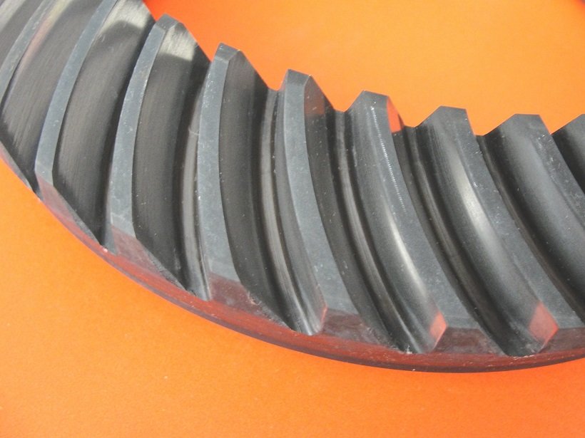

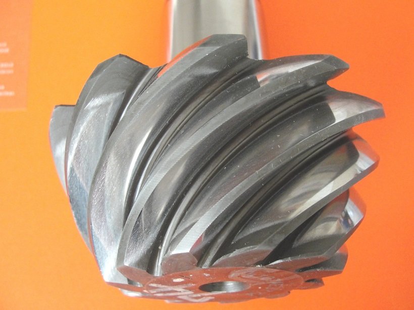

    Hopefully this info. helps people on the fence about re-gearing. Here are some shots of my stock 3.73 ring and pinion with only 15K miles.

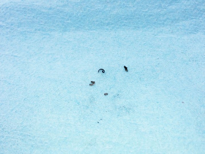

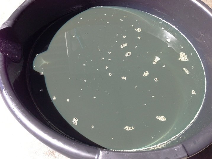

    I reached the 500 mile mark so it was time for the mandatory fluid change. The front diff fluid was just slightly darker than the new Amsoil 80w-90 that was put in when the gears were installed. The rear diff fluid was a different story; it was dark and smelled rancid. Both the front and rear drain plugs were coated with a thick layer of dark metal particles and a few shavings.
    The break in schedule I followed were heat cycles of 15 miles with varied speed and nothing over 50 mph. After 15 miles I would stop and allow the rear diff to cool enough where I could keep my hand on it. The 500 miles were broken up over a 10 day period.

    Rear Diff Fluid
    Metal shavings from both drain plugs
