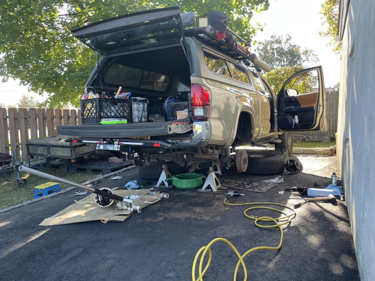

    2018 4 cylinder ACLB. ECGS 5.29 on the rear waiting for good weather to do front. So far im happy.
