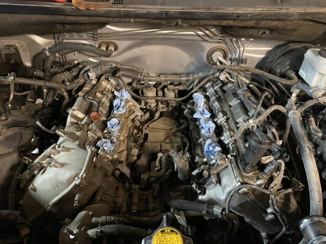

    Other than coal tower leaks I rarely have a 3ur in with issues at work.
    That being said I’ve done a TON of cam tower reseals

    I've been quoting tensioners with the cam housings now. So many are stuck maxed out now and rattling, so I combo it.
    Hate the cam reseal so much. I've never done the sneaky method yet.

    sneaky methods the only way to make the warranty time kinda worth it.. but its a pita
