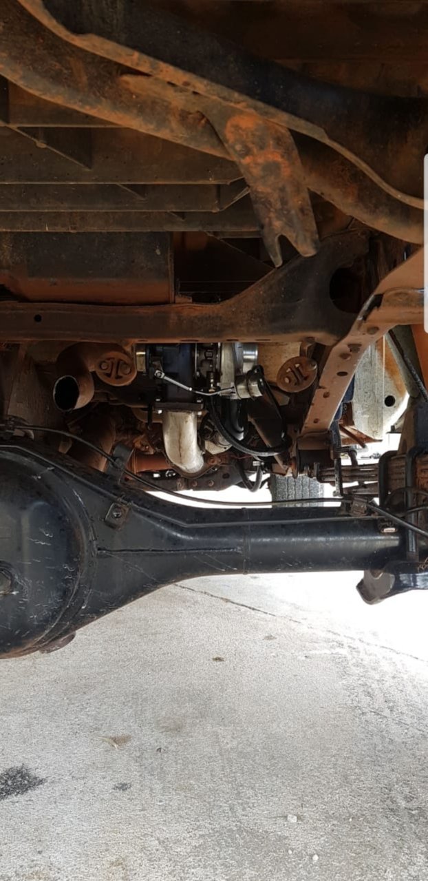

  16. Jul 15, 2018 at 4:43 PM
    #96
    v8taco671
    v8taco671 [OP] Well-Known Member
    Apr 2, 2017
    #215117
    156
    The v8 taco is now boosted
    MY50cal, NYCO, vrod671 and 7 others like this.

  18. Jul 15, 2018 at 4:47 PM
    #98
    toysrgood
    toysrgood Well-Known Member
    Apr 21, 2011
    #55327
    2,302
    SC
    2011 4x4 Reg Cab
    Dude... That's insane! I'd love to see some more videos of this thing in action.
  19. Jul 15, 2018 at 4:50 PM
    #99
    toysrgood
    Apr 21, 2011
    #55327
    2,302
    SC
    2011 4x4 Reg Cab
    What's the intake piping look like? I can imagine that turbo will be seeing some serious mud and water. I'm curious how it will like that abuse.
