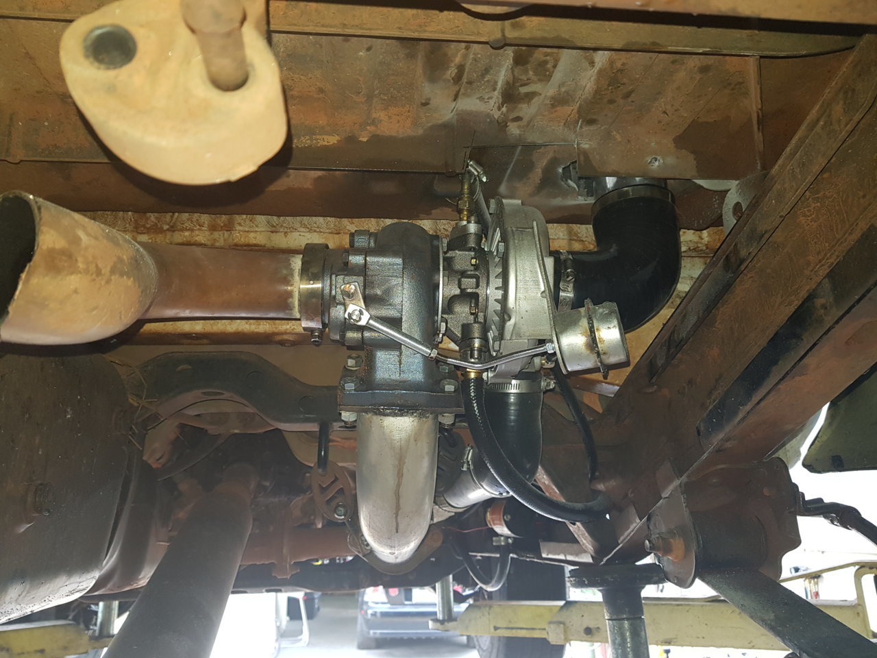

    7,662
    Olympic Peninsula
    Why that location?
    beertimecontinuum likes this.
  3. Jul 15, 2018 at 5:35 PM
    #103
    Bishop84
    Bishop84 Well-Known Member
    Dec 17, 2015
    #172494
    11,676
    Loads of room there, single exhaust outlet to turbo, makes sense.

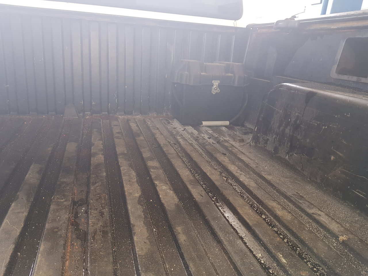

    "Battery box"

    When I finish the exhaust

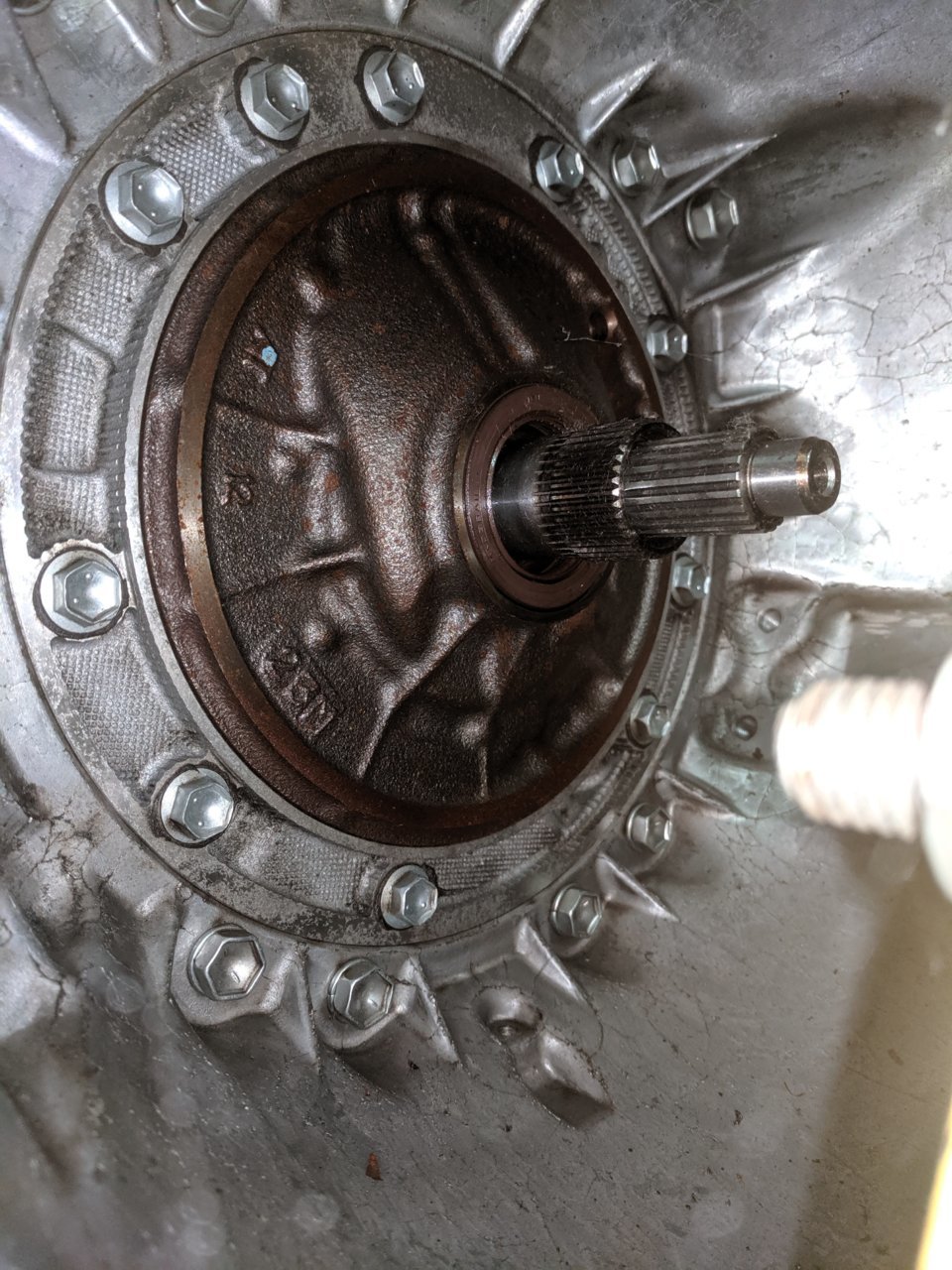

    Anyone know if a 4runner v8 trans is the same as a Tacoma v6?
  15. Sep 14, 2019 at 8:23 PM
    #115
    bobsuruncle
    bobsuruncle PhD in voiding warranties
    Feb 17, 2015
    #148863
    7,335
    Bob
    Fall City, WA
    06 TRD OR DCSB
    ARB bull bumper Warn XD9000 Icon 2.5 EXT Road Armor rear bumper Archive Garage shackle flip FJ/T4R tcase 4.30 gears Dirty5’s T4R rear axle swap w/disc brakes New frame from Toyota under EWP
    As in an A750F? IMO yes, an A750F is an A750F, doesn't matter what vehicle it came from, it's an A750F. Is that what the dealer or other people say? Not quite. I've been searching for a replacement 750F to my 06 1GR, and I've been told over and over and over that only 05-07 a750f's will work with my 06. No one can tell me why though. I'm currently sitting on a 2012 t4r a750f with manual shift tcase that I'm planning to swap into my 06 Tacoma despite everyone saying it won't work. :notsure:
    Worst case, I'll just swap the tcase.
    If your wondering if you can just buy the 2uz and if it will bolt up to your current a750f, I'm gonna say that's a 99% yes. You may need to find a bellhousing for the 2uz for your current transmission as the 1gr bellhousing could be different. It's about 10 or Sol bolts to switch bellhousings on the a750.
