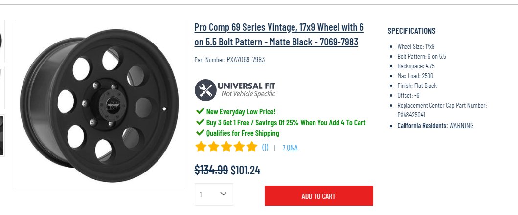

    I recently bought a 14 TRD OR DCSB. after some research I have decided to buy adjustable 5100's and will use my current coils for the front, likely set at the "2.5" notch. I also got a 1" block for the rear. I plan on running 285/70R17 Nitto Ridge Grappler or Terra Grappler G2's. (loved the terra graps on my rubicon last year). i considered 275/70-r17 but the selection is terrible
    My question is in regard to backspacing. It seems all the 17" wheels i find are 4.75" BS, or not listed via tire rack or discount etc. I am looking at some basic wheels such as these
    from Pro Comp, they have a -6 offset with 4.75 back spacing, 17x9. Will this cause fitment issues? i am prepared to do some trimming but hope to keep it to a minimum. My truck is a daily and mostly used on road. the only real off road it will see is a mile two track to the gun range and some seasonal roads here in Michigan.
    any thoughts? i have searched a lot over the last few days, and didn't want to contribute to the 54,345 post about wheel fitment but i cannot find what i am after, so to the experts i ask, please help me haha.

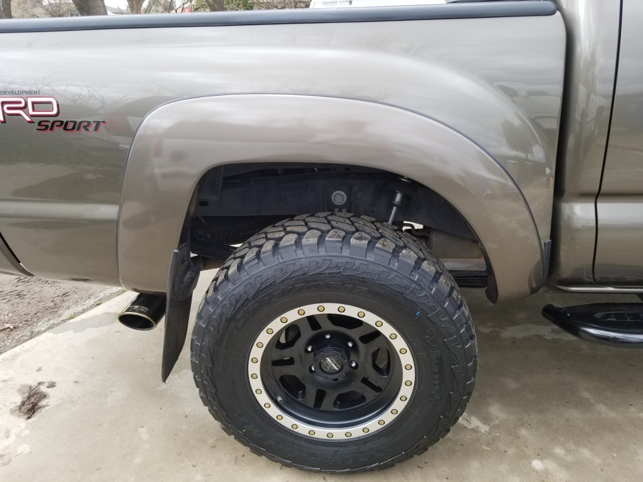

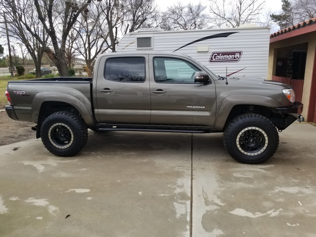

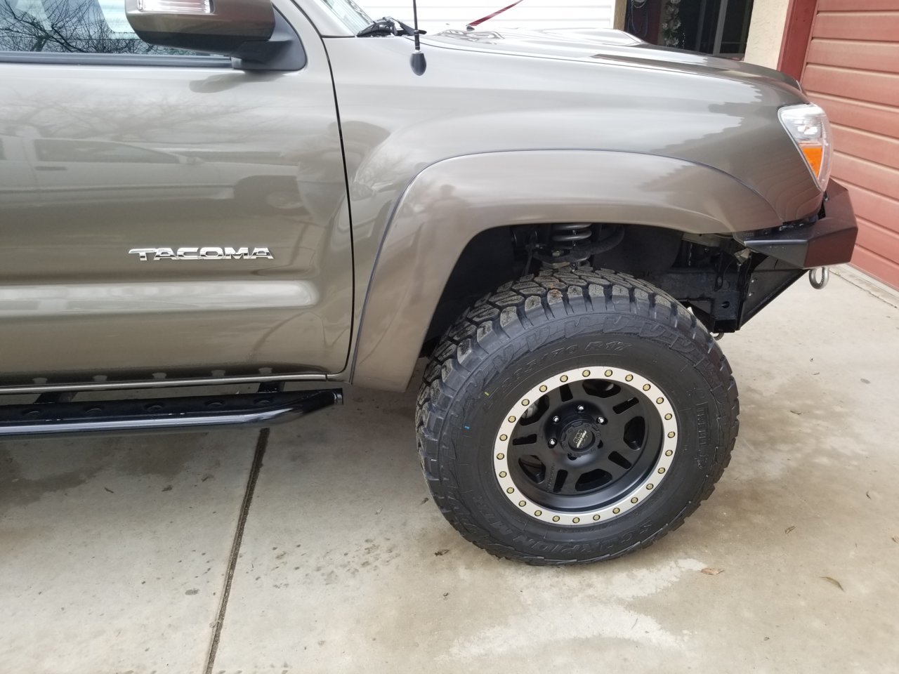

    I am running 4.75 BS 285x70x17. Had to do a CMC, hammer pinch weld, and minor trimming. Wish I would have stepped up to 35s.

    Was at 3", but with the bumper, winch, skids, sliders, I only lost a small bit on the lift. No rubbing and I use it offroad.

    I would go with 0 offset.
