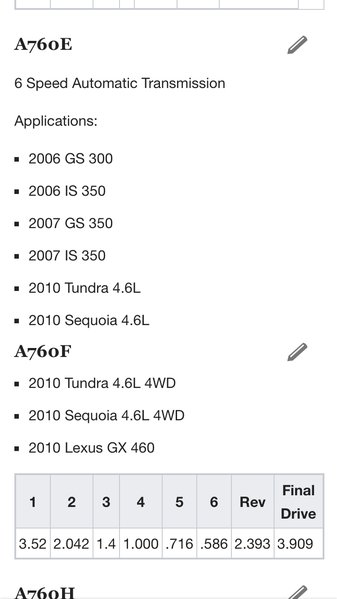

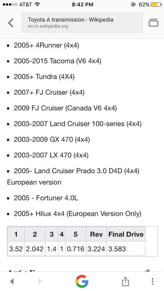

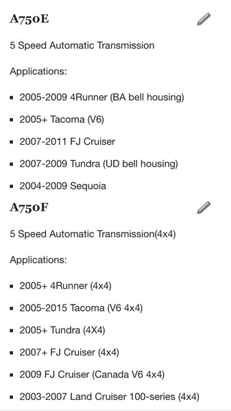

    Nope, I was wrong... 4.6 is not mated to the a750.
