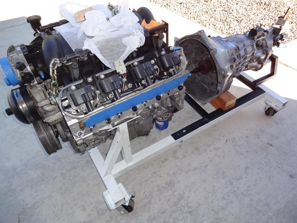

    I've contemplated a early tundra V8 swap (later on when my Taco is older) versus getting a supercharger now. Its a DD now but would really like to be able to tow with it later on. Having multiple specific purpose vehicles is nice but I'm not Jay Leno so doing the maintenance myself will be a burden.
    I've been working on swapping a LS motor into my classic and while sorting through wiring, I found its nice that manufacturers will color code certain wires the same color (i.e. starter). But if you want amenities like cruise control, that will be more difficult.
    I've seen people do a lot in their garage. I made this cart to do work on and push my motor and trans around. Comes in real handy. I'm confident I can knock out some engine mounts if I had to.
