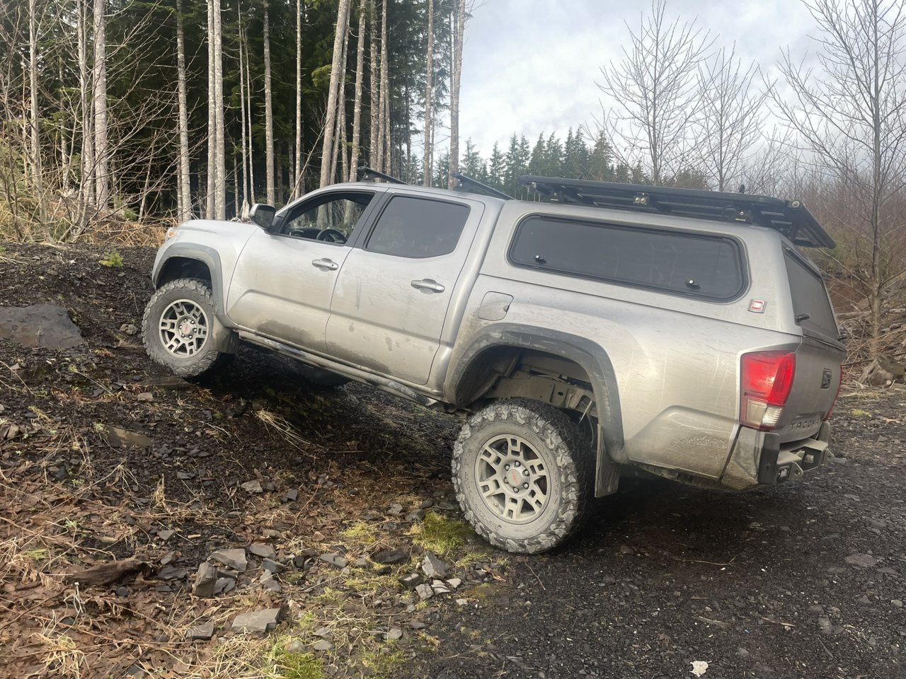

    I figured I’d share my thoughts on 4.88 gears in my 2017 TRD Off Road Automatic, running on LT275/70/17 tires, after 6 months living with the gears. I didn’t want to share any thoughts right away as I wanted the “gears honeymoon” to wear off completely, and have a chance for buyer’s regret to set in.
    FYI: My truck has steel sliders, steel stub bumper and winch, steel rear bumper, and a fibreglass canopy with roof racks. I am running E-rated BFG Ko2 in 275/70/17 (just over 32”). My engine in not tuned, but has the latest OEM calibration for the ECU. You can check out what I’ve got bolted to the truck in this thread:

    What rear bumper is that?
