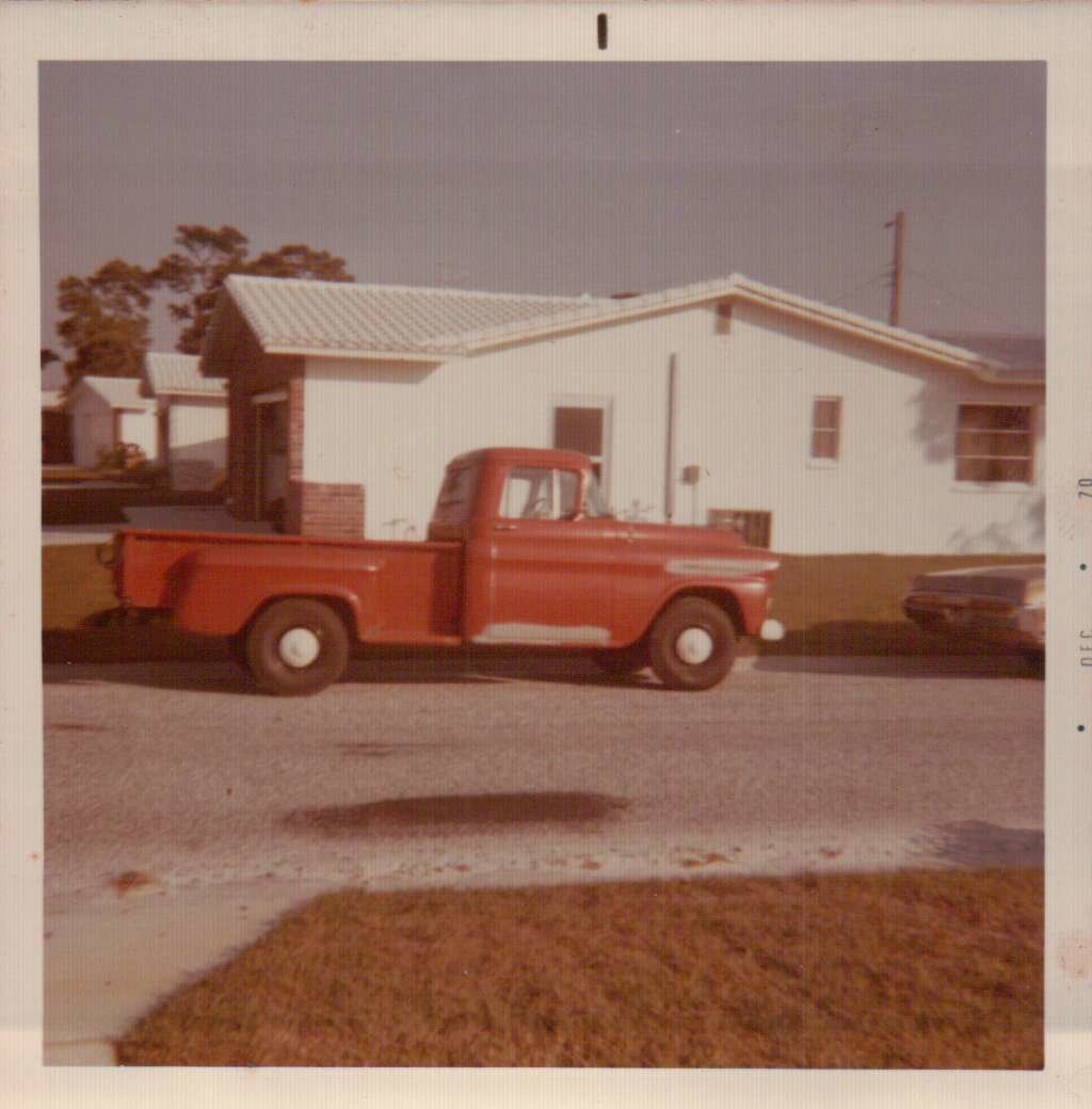

    Clearwater Bill
    Clearwater Bill Never answer an anonymous letter
    Oct 11, 2014
    #140097
    24,965
    Billy
    Largo Florida
    '13 5 lug AC w/convenience package
    A few OE parts from fancy trucks
    You should have heard the whine in this thing. All stock too.
    3/4 ton, 4 speed w/granny, floor starter, 4:56, nylon tires, split rims, all steel, rubber 'carpet', wood bed floor. Luxuries included heat and an AM radio, wing vents, floor vents.
    Horrid MPG, totally impractical on the highway.
    But it was a truck. And did truck stuff of towing and hauling heavy stuff.
