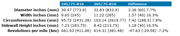

  19. Sep 21, 2016 at 7:36 PM
    #99
    Juggernaut
    Juggernaut Captain
    Sep 21, 2009
    #23111
    1,908
    Sacramento
    25 TRD OffRoad DCSB
    With 285's you will lose 8% gearing plus the added weight at a larger diameter really compounds the inertia you have to overcome.
    Compared to stock 3.9 gears:
    4.30 ~10%
    4.56 ~ 17%
    4.88 ~ 25%.
