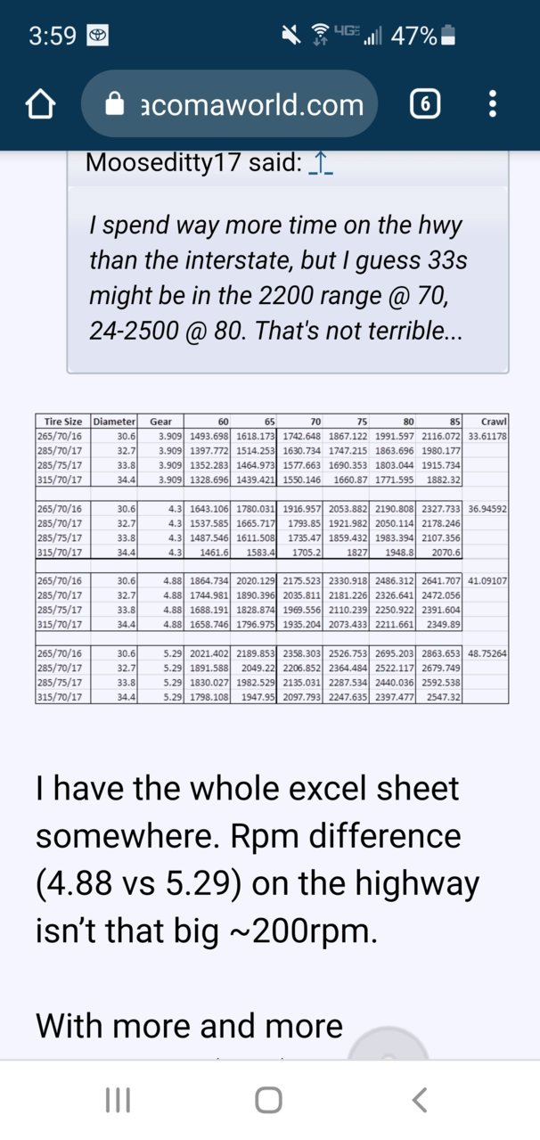

    In my opinion, there is no reason to choose 4.88s. 5.29 on stock tires will be 2400 at 70….on 33’s it’ll be 2200. There is absolutely no benefit from 4.88 running at less rpm. There’s already barely enough power to maintain 2200 rpm at highway speed.

    Exactly, the difference is so small its difficult to even discern without intense focus.
    You're going through a huge hassle upgrading gears, just do it once and be done with it. You never know how your build may progress in the future. Set yourself up for success.

    Run skinny 33s (255) on OE wheels, or wheels with OE specs, and you don't need any lift, no rubbing, no cutting. Several good threads on them.
    The tire calculator shows how sizes impact final gear ratios, which might help your choice.
    Since you don't off-road much, do the tires first and see how the size and weight change feel to you. Probably more sluggish. It might influence your gear choice
