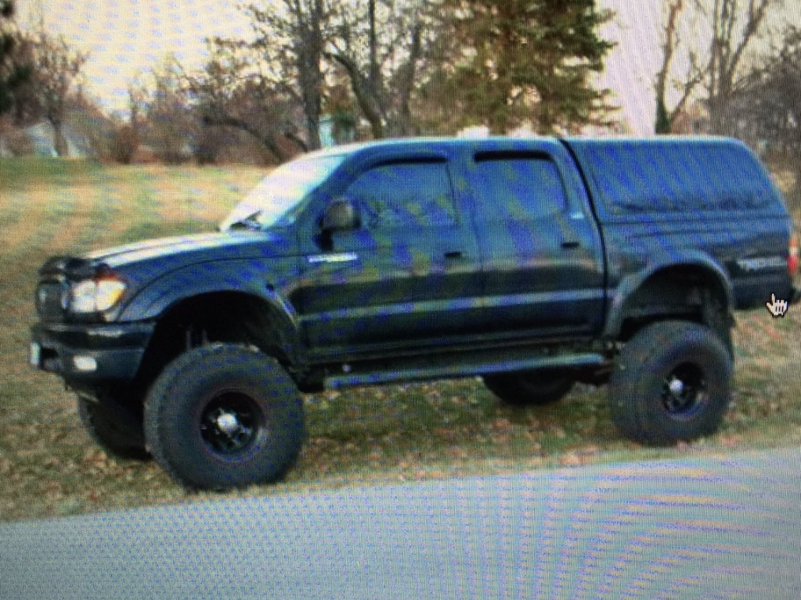

    I remember on my 04 Taco….calling Yukon and doing the math and they recommended 5.29’s then for my setup.. I thought for sure 4.88’s…. I bought the 529’s and they were amazing.
    I ran 5.29’s on my 31” tires on my 23 taco for a bit….. still awesome.
