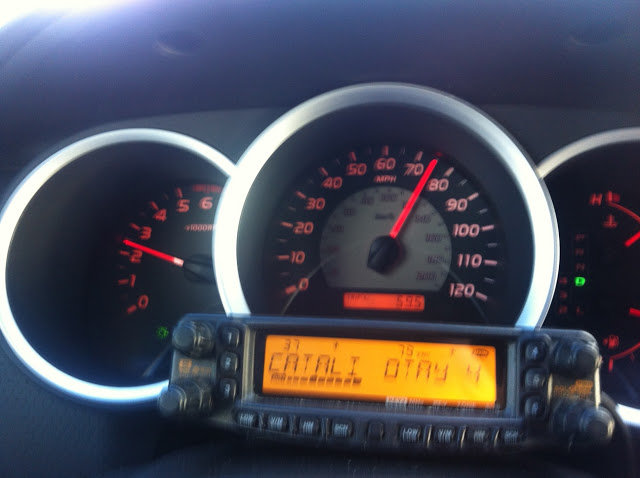

    Agreed on the speedo being off.
    This is a picture of my speedometer with 35's, 4.88's and the speedometer calibrated.

    You have to buy one of those speedo calibrator things that wire into your ecu... Search it and you will find a few threads on various ones. They typically cost about $200 though... You can get an Ultraguage for almost a quarter of that price and then just calibrate it with a gps and it will tell you how fast you are going and many other things:D I like mine.

    No. The ultraguage will keep track of how many miles you travel via the reading from the ECU. You can use a GPS to go out and measure how far you actually drive one of the times you drive and input that into the ultraguage and it will calculate the percentage the ECU is off by and then display the new corrected speed. It's pretty easy to do and you only need the GPS that one time and then after that you could just use it to verify that the ultraguage is reading correctly.

    Toyota will not and cannot adjust the speedometer. I have tried at 4 different dealerships around me.
    The Ultragauge (UG) will not adjust the speedometer, it will just display the new speed on the UG. That's a pain in the ass for me since my UG is mounted by my cigarette lighters. So this may or may not be good for you.
    The only way I have found to calibrate the speedometer easily has been the Hyptertech Inline Speedometer Calibrater. Takes about 30 minutes to calibrate.
