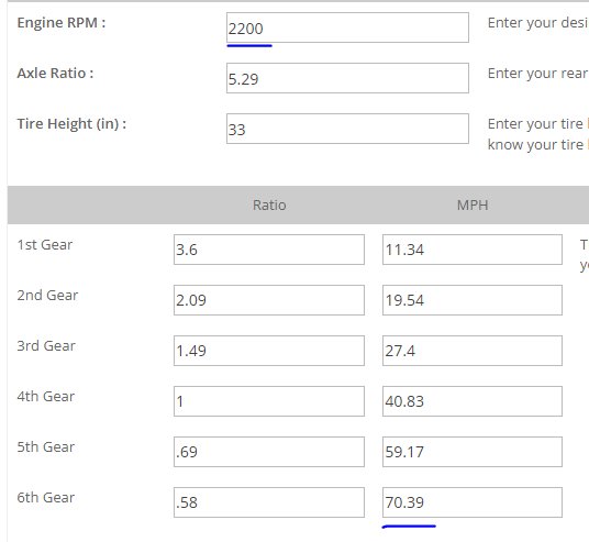

    I'm going to go with 33s and 5.29 gears. It is perfect gearing. I just tow at 60 or 65 everywhere I go, so this is actually higher rpm than I'd run, and of course the offroad performance would be much better
    I use this calculator
    https://www.tremec.com/calculadora.php

    I showed the rpm for 70mph, and there're stock cars with higher rpm than that at that speed. That's not even close to being to high a range.
