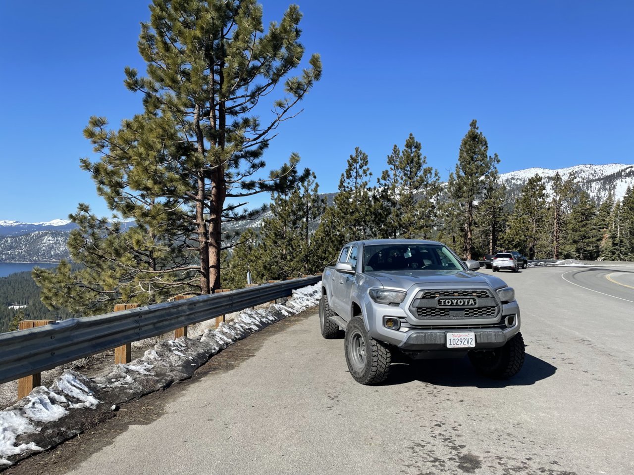

    Nothing off. these were number i recorded driving down the highway on cruise control. My speedo is corrected with a hypertech and accurate speeds to GPS. I'm running pretty heavy Cooper ST Maxx 285/75/16's they measure at 32.9" on their website. I was running around 35psi all 4 corners. I looked again and my actual best MPG was 16.91 That is corrected number and was from the CA bay area to south lake Tahoe and back. up highway 50 and home. about a 250mi trip. During this trip I'd estimate my vehicle had around 600lbs of total added weight between steel sliders, aluminum skid plates, full size spare, larger battery, tonneu cover, bed mat and gear. Vehicle is lifted about 2 inches on all 4 corners and tuned with OVtune 2.0 during this MPG test.
    Since then my vehicle is very loaded down with a FWC swift. MPG has decreased even more, but to be expected. I bet without my camper and lighter tires i could see MPG numbers closer to 17.5 on long highway trips.
    I'll upload some pics of my truck around the time when I hit this best mpg of 16.91 mpg. around town where I live it's very hilly and i have a work commute of about 16 miles round trip where i'd get only around 14.5 mpg even trying to drive extremely conservatively. These are just my numbers, i'm sure others may differ.
