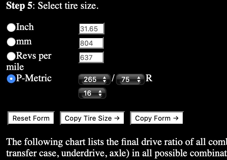

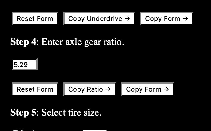

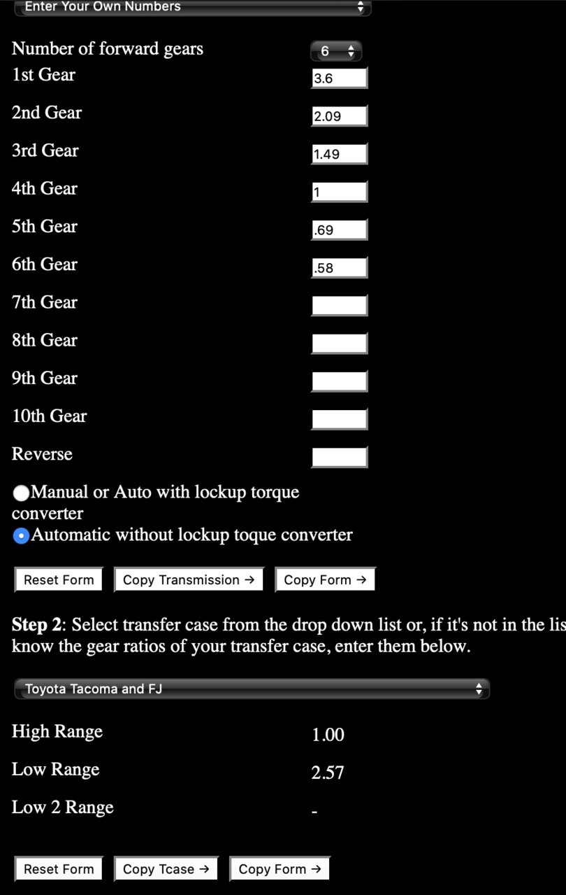

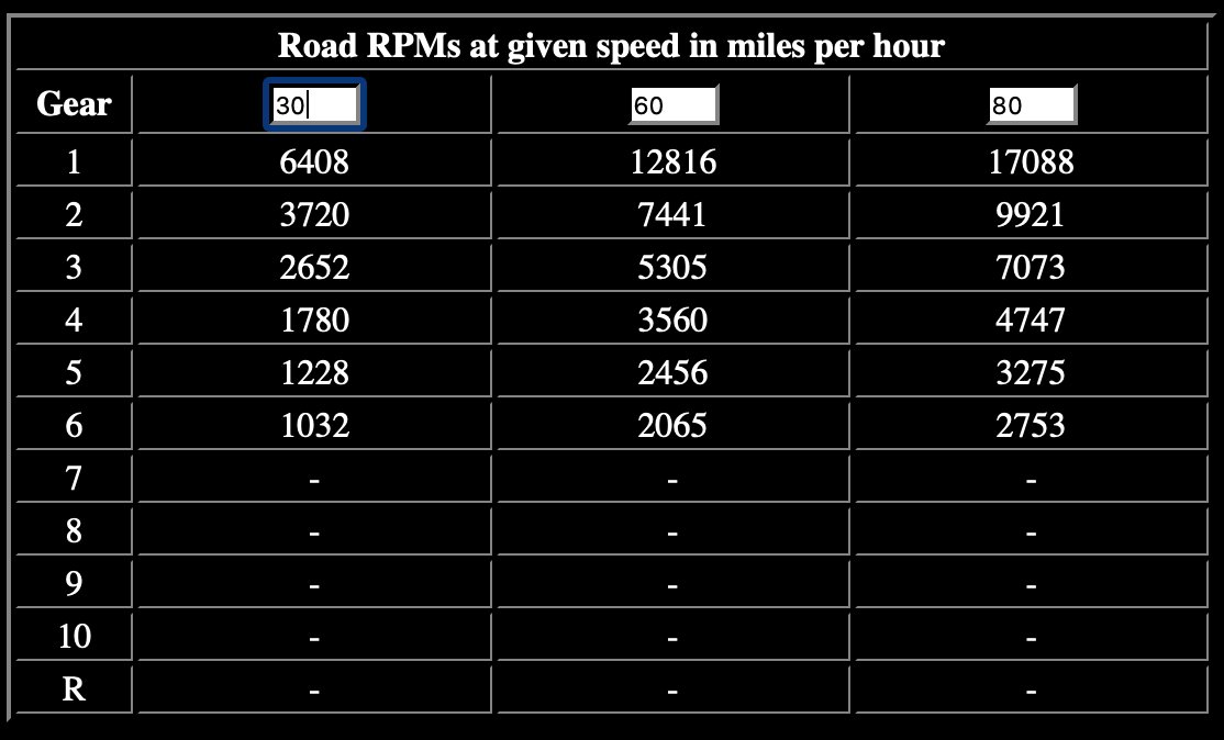

    Wait so 5.29's would be 2600rpms at 80mph in 6th? Not bad...

    I never liked that site because Idk if Im inputting the numbers correctly...that being said, would anybody double check my work?
