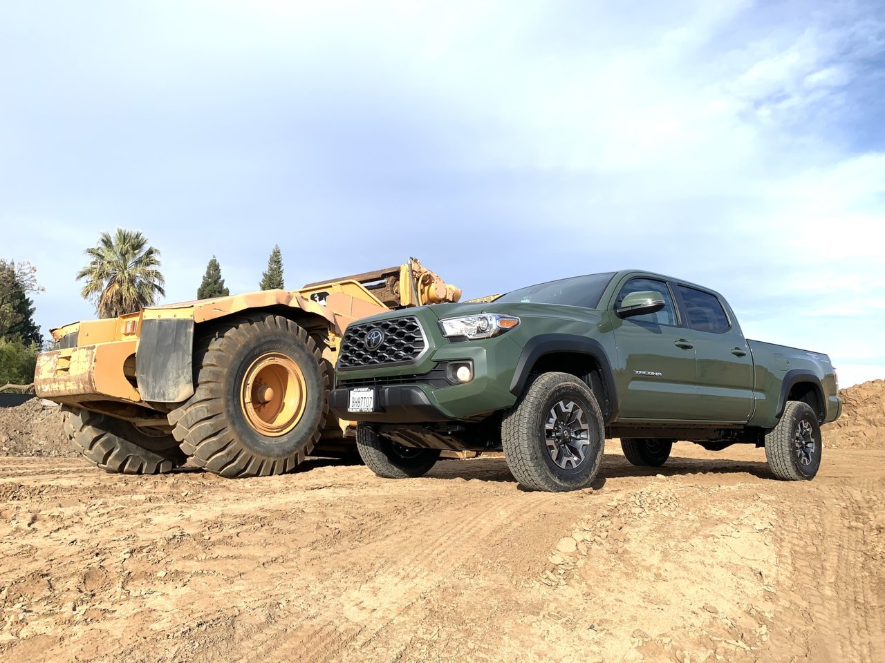

    I ended up going with 4.88 and running 265/75/r16. I also went with a much lighter wheel so my overall rolling mass is just a little more than stock. happy with the 4.88, but don't think 5.29 would have been too much.

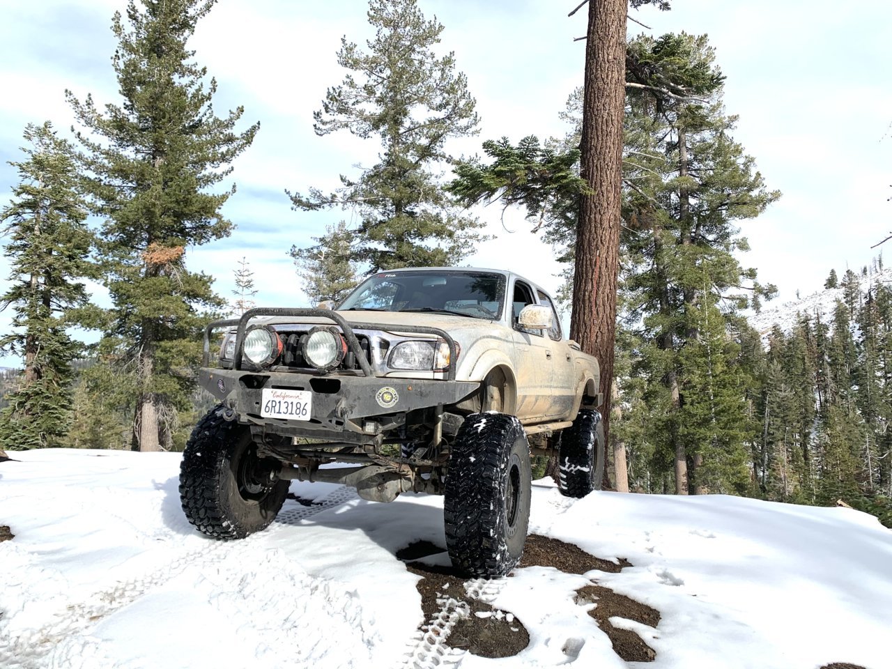

    8C20F943-33CA-494D-AAAC-D37762CEC810.jpg F7C7B8E3-9AC0-4129-9A57-BDFBD10BBBCF.jpg F7C7B8E3-9AC0-4129-9A57-BDFBD10BBBCF.jpg And no one is talking about loosing your top speeds when you regear.
    4.88 on 35s I lost 5 mph on my top speed.
    5.29 on 35s I lost 7 mph
    4.88 on 37s I lost 4 mph
    In my opinion 31 stock tires on 5.29 is way over kill unless you going 35s. If I'm going to regear and running 32-33 tires 4.56 is what I'm aiming at...just thoughts.
