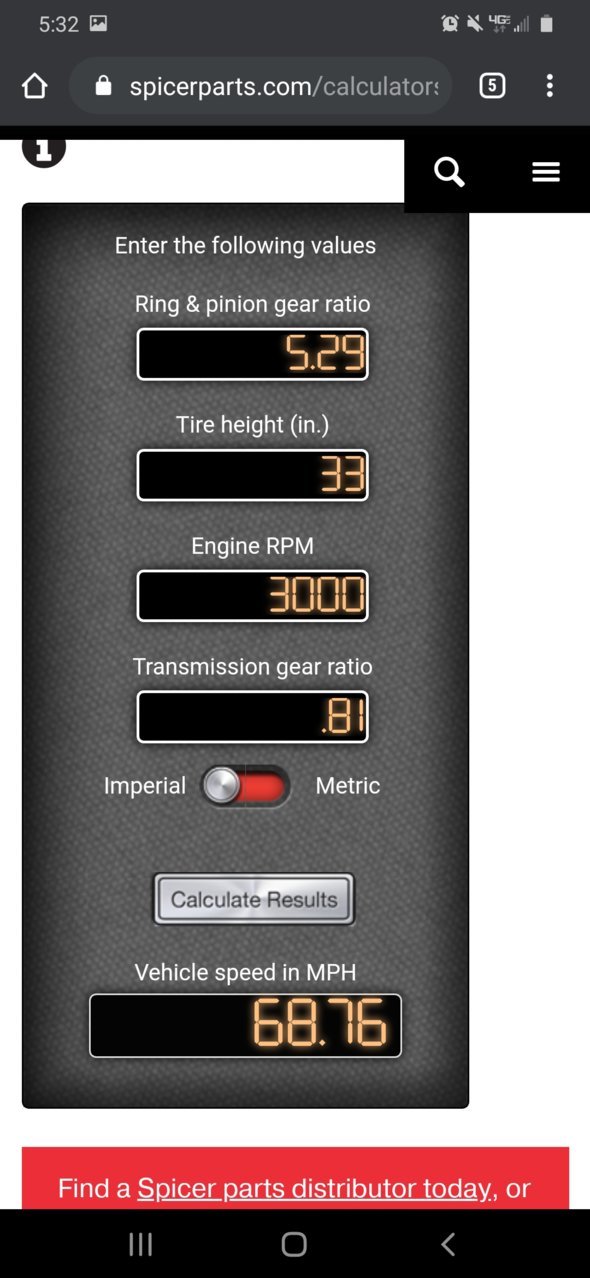

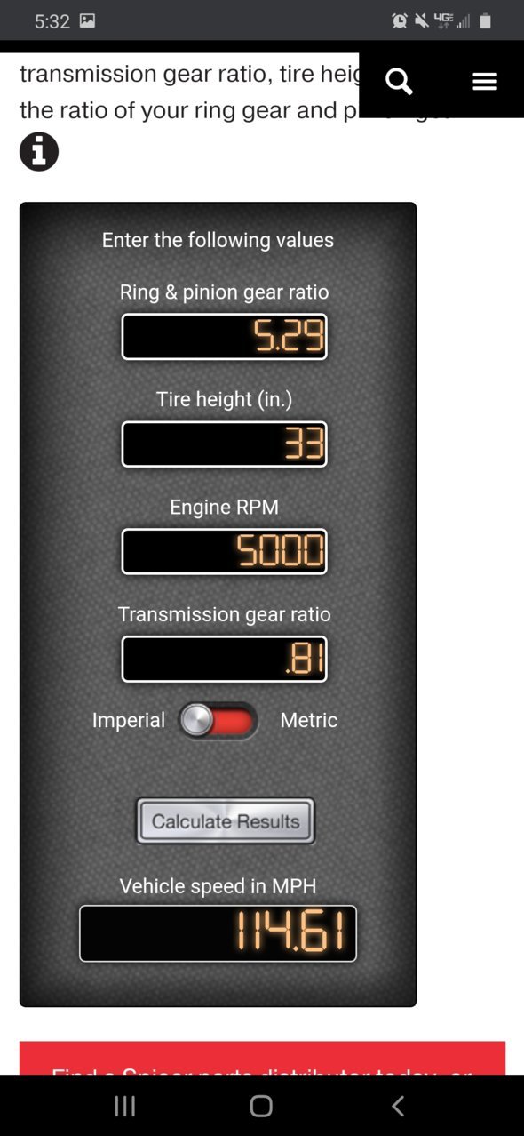

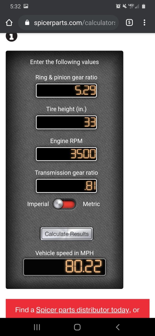

    Not a thread jack at all. I was thinking the same thing. I was just driving 80-85 limit is 70 so no broken laws yet. leaning towards 5.29 since with stock gearing and 31s i was running around 33-3400 rpm at 80.
    Eta: i think our 1st gens have a .83 5th gear, its on marlincrawlers website. Correct me if I'm wrong.

    Good catch, 4cyl w59 is .85 and v6 150 is .83
    I dont know where I got .81 from!
    I heard driving in one gear lower on the freeway is about the difference you experience with a gear swap. A hit on mileage is ok to be able to go the speed limit up the mountain.
