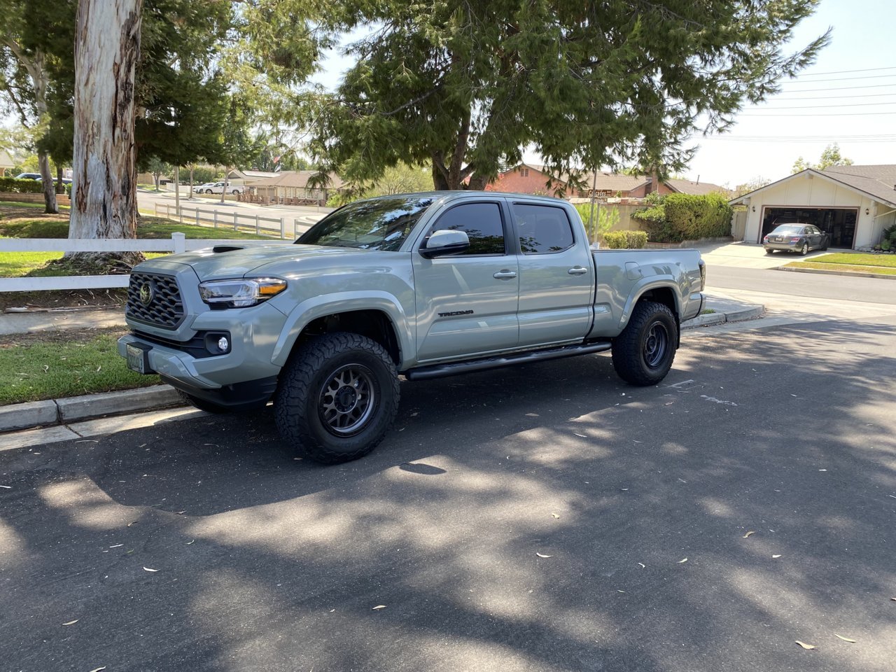

    2022 Tacoma sport 2x4 AT
    k02 285/70R/17 2.25 Bilstein lift
    I have a tuned AT 2022 2x4 Tacoma sport double cab. With K02 285/70R/17 KMC wheels, Possibly add a prinsu roof rack and call it good as far as the mods go.
    It’s my daily driver, I live and work in Southern California and won’t be towing anything more than my Mountain bikes.
    Will 4.88 or 5.29 be best for maximizing mpg?

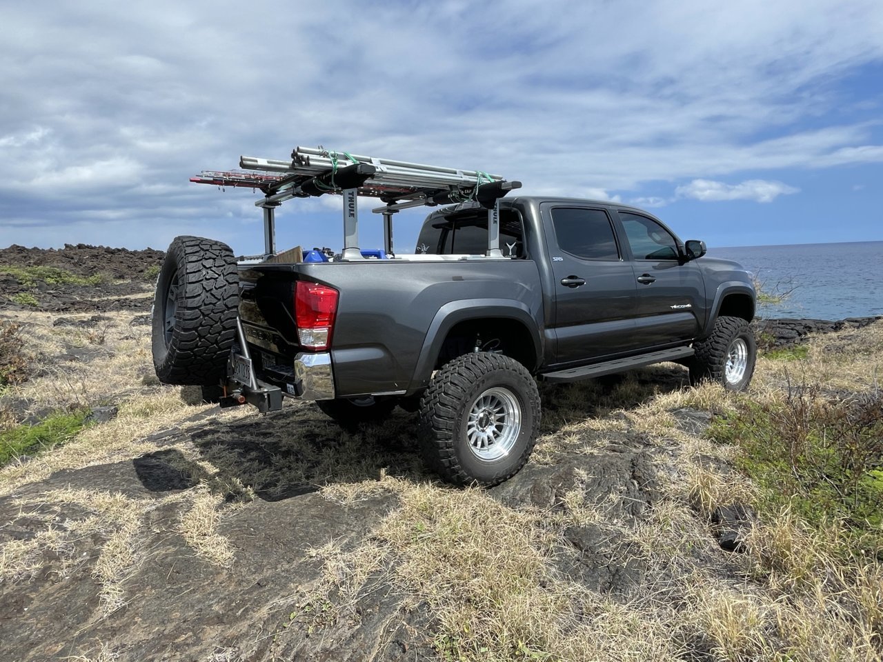

    2017 MGM DCSB
    Pro Comp 6", full length 5100's with OME 888 w/ taco lean spacer, 5160s w/ Alcan custom pack, HS extended brake lines, Summit offroad Dakar 17x9, 315/70/17 Falken Wildpeak MT, Nitro 4.88 regear
    I used to have 285/70 paired with 4.88’s.
    It was better, but during that time period of the install 5.29’s wasn’t offered…
    I read somewhere the difference at 60 (could’ve been 65) mph was 700rpm
    In the long run I wish I went with 5.29s. I mean, we do have 6 gears - your highway rpm won’t be screaming, but probably, more useable.
