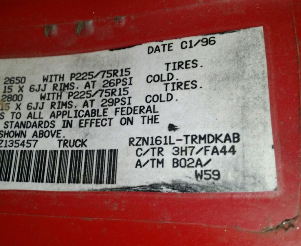

    A04a gear code
    I'm getting mixed results when checking gear code charts. WTF DO I HAVE!
    2.7l with auto tranny
