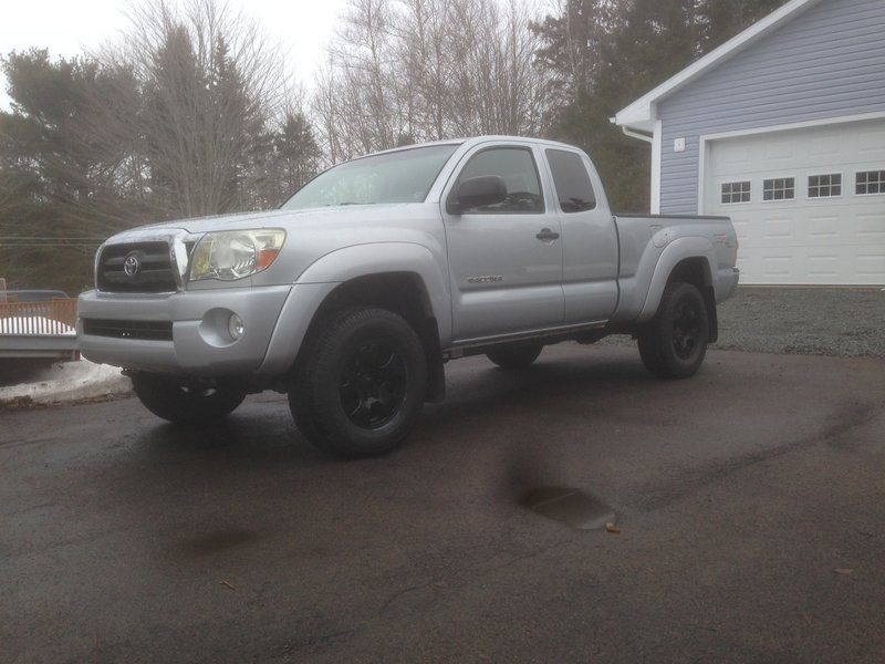

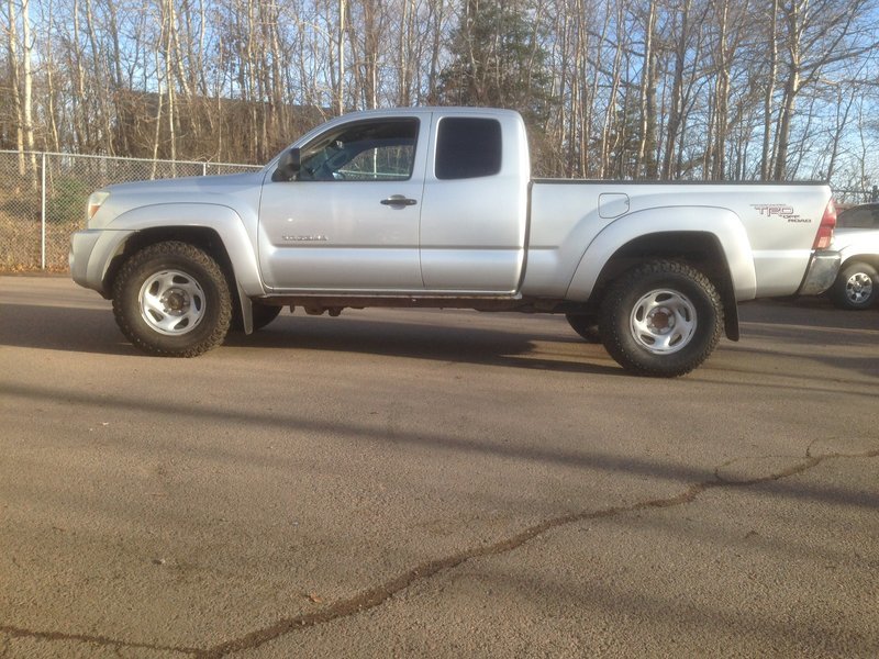

    To the best of my knowledge trd off road coils are different, than non off road models. I got at least 1.75" on the 0.85" setting. My truck went from thisimage.jpg
    Rear tsb springs, 3+1

    Measurements:
    All taken from centre of hub to fender flare.
    Front on stock trd off road coils with 5100's set to 0.85" = 21.5"
    Rear tsb 3+1 leaf springs = 23"
