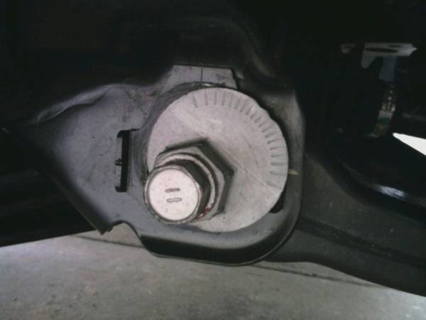

    This would be a good starting point.

    What did you have done to fix that?

    Mine was like that. Bent it back and it's been fine since.
