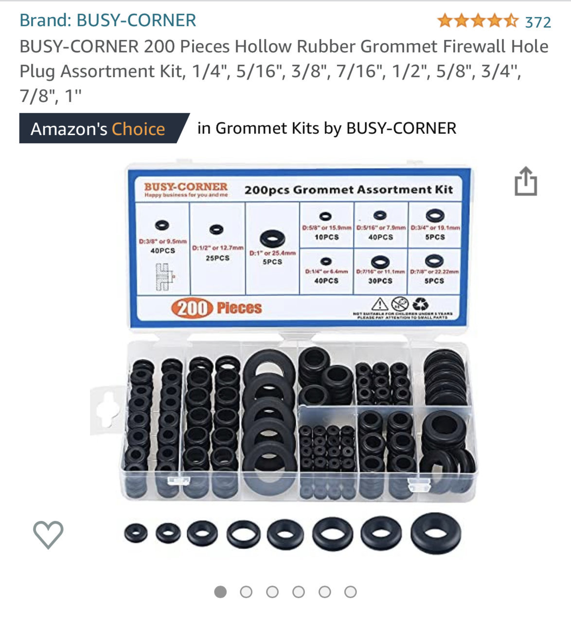

    Hi all,
    I'm running some 4 awg cable into the cab side of my bed, probably coming in just under the bed rails.
    I have some OCD. Are there any pass throughs or entry glands anyone can suggest to keep it neat and tidy (and ideally somewhat sealed)?
    The cable I'm running is about 0.305" in diameter and there will be two of them
    Thanks for any help!
    Scott
  2. Mar 29, 2022 at 5:08 PM
    mquibble
    mquibble Well-Known Member
    Dec 26, 2020
    #350714
    1,603
    Michael
    2021 TacomaTRD Pro
