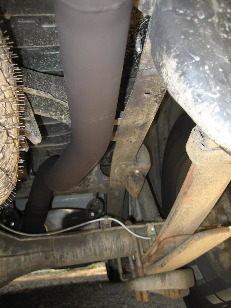

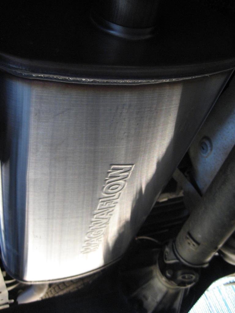

    After running the large 22 inch MagnaFlow for over 2 months now...
    ...I'm totally pleased. The deep mellow sound isn't the least bit irritating and there's no cab drone. :)

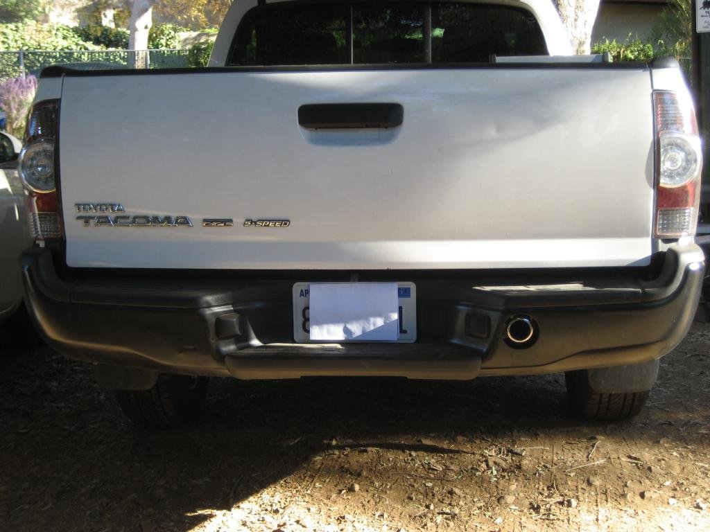

    The muffler is 2.5 in and out, but everything was replaced from the muffler back so the tubing going into the muffler remained the existing stock metric 2 3/8" OD, and I had 2 1/4" OD tubing mandrel bent...
    ...to exit a hole I cut in the rear bumper.
