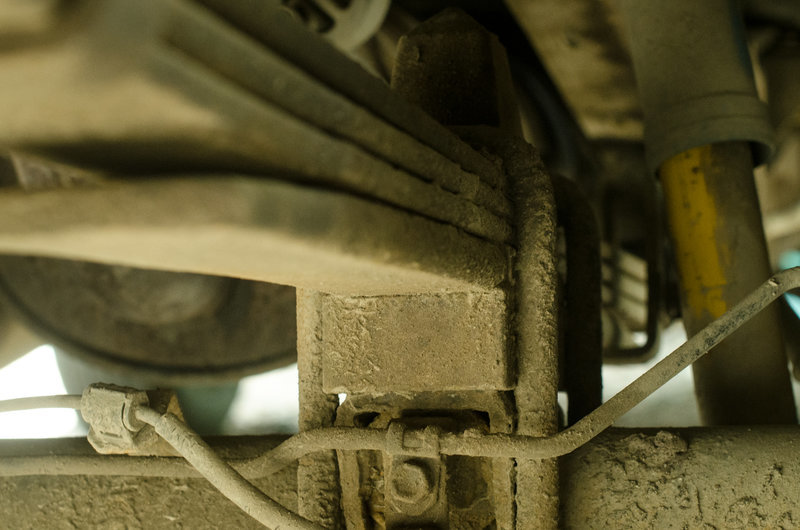

    Maybe post a pic of your leaf spring pack and spring perch area so people can see which pack you have and if you have a rear block.

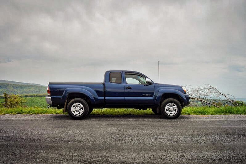

    T4RFTMFW
    T4RFTMFW Well-Known Member
    Jul 23, 2014
    #134525
    69,757
  4. May 18, 2016 at 9:52 AM
    T4RFTMFW
    Jul 23, 2014
    #134525
    69,757
    ChadsPride and AR15xAR10 like this.
  5. May 18, 2016 at 9:53 AM
    T4RFTMFW
    Jul 23, 2014
    #134525
    69,757
    3 leaf is levelish at .85.
    4 leaf is levelish at 1.75.
    ChadsPride likes this.

    You should show us some good pictures of your spacers and all around your leaf springs and rear axle so we can see how much your "leveling" spacer is and if you have any rear lift blocks.

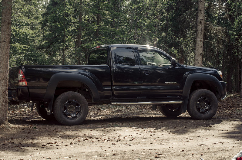

    This is what i just did:
    Front: 5100s set on 0.0" with OME 883X coils and driver's side aluminum top plate spacer (to combat the "taco lean" caused by the driver's side having the driver, battery, and gas tank all on the same side of the vehicle)
    Rear: 2014 OEM (4 leaf) TSB/Recal leaf springs with new oem bump stops, new ubolts, and hardware. Plus 0-1" rear 5100s.
    I gained 1.5" over stock in the front and 0.5" over stock in the rear. The truck sits perfectly level now that the coils have settled.

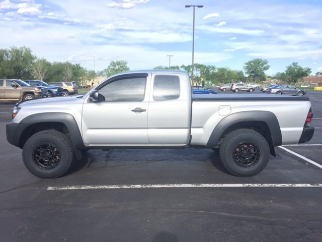

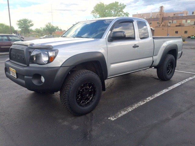

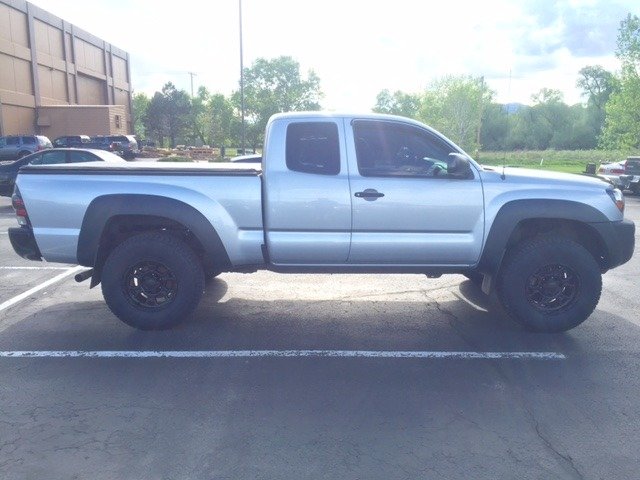

    Just for reference, here are some pics of mine after getting the recall leaves installed with 1.75 5100s and stock coils up front. Rear end didn't come up as much as I thought it would (I feel like it only came up 3/4" or so from the busted 3 leaf pack). I took measurements and have about 1/4" difference side to side and it's within an 1/8" of level from front to back. I'm going to see if things settle as I'm kind of expecting the rear to drop a little, then I'll take it from there. And for what it's worth, I am loving the ride at 1.75 with stock coils so far. I haven't noticed much difference in stiffness, but maybe I need a little more ride time.

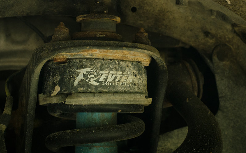

    Here is what I have in the front.
    Never paid much attention to the back to be honest... not sure how much the block makes the ride.
    ... I could just get rid of both spacers/blocks but wouldn't mind upgrading the front suspension at least and go with 883s/5100 shocks (or the OME ones depending on what I can get shipped here).
