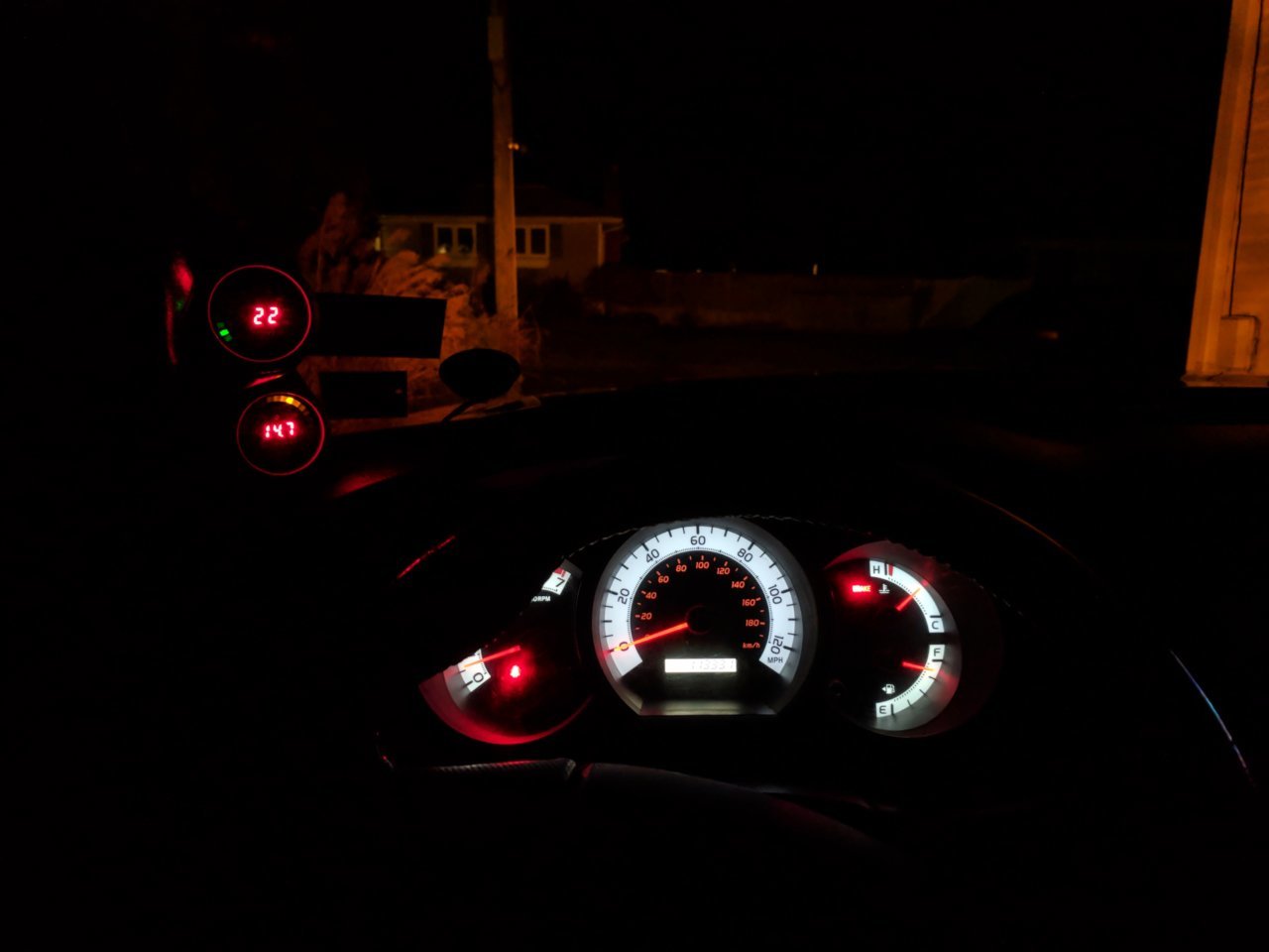

    Hahah what would you like to know?
    Turbo: Garrett GT2871R (T25 w/5bolt exit)
    Wastegate: Kinugawa adjustable internal @8psi currently
    BOV: HKS SSQV vented to atmosphere
    Manifold: ShanghaiWaystar topmount
    Intercooled: Yes. Some eBay front mount kit lol
    Downpipe: ShanghaiWaystar
    Exhaust: Stock catted, with Magnaflow muffler
    Fueling: Stock injectors, pump, and FPR on 93 octane
    Tuning: Stock ECU, switching over to AEM F/I-C for safe closed-loop tuning
    Clutch: LCE Dual Comp (Stock couldn't hold the extra power)
    Do I have a CEL on? Yep- for the SAIS since I haven't tried the @slyfox75 bypass or the @hewitt-tech bypass yet. The pump and all components are present, but the CEL does not put the truck into limp mode. Eventually I'd like to delete the whole system. I just reset it every few days right now since I'm more focused on other things like upgrading injectors and the pump so I can run E85.
    How fast is it? Well I can hold a dead even pace with a Ram now, and the V6 Tacomas are a joke. When it's wet out, I have to be careful to not jump on it in 2nd gear, otherwise it'll break loose. The GT2871R spools extremely quickly, and I can make 4psi of boost by 2500rpm. Right now on stock tuning, I don't like to build boost in closed loop, as the AFR will be at 14.7 (stoich, but too lean for boost). Once open loop hits, I have plenty of fuel to reach 11.0-11.5 AFR (ideal under boost).

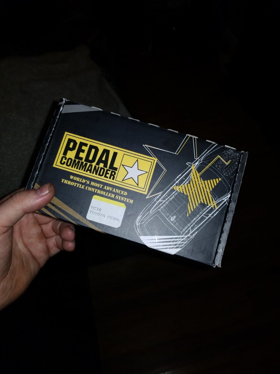

    Vehicle Modifications: TACOMA 2007 FRONT TOTAL CHAOS 5LUG ,LONG TRAVEL KIT 13" OF TRAVEL KING COIL OVER (550 POUND SPRING RATE) (18 INCH COIL) REAR BED CAGE 16" SMOOTH BODY FOX SHOCKS 2.5 2.0 / 2.5 BUMP STOPS FOX ICON ADD LEAF PACK WITH OEM SPRING 11" OF TRAVEL TRUCK COMES SPRING UNDER BY MANUFACTURE TOYOTA REGEAR TO 4.0 WITH AUBURN UNIT ENGINE 2TR-FE WITH AFE COLD AIR IN TAKE DOUG THORLEY HEADER MAGNAFLOW EXHAUST TIRE S NEW KO2 32/11.5 METHOD RIM 15" WITH -20MM OFF SET

    The pedal commander looks pretty great, and reading up on it led me to info on spark plugs... I'm gonna get new plugs first, then re-evaluate. Thanks dude
