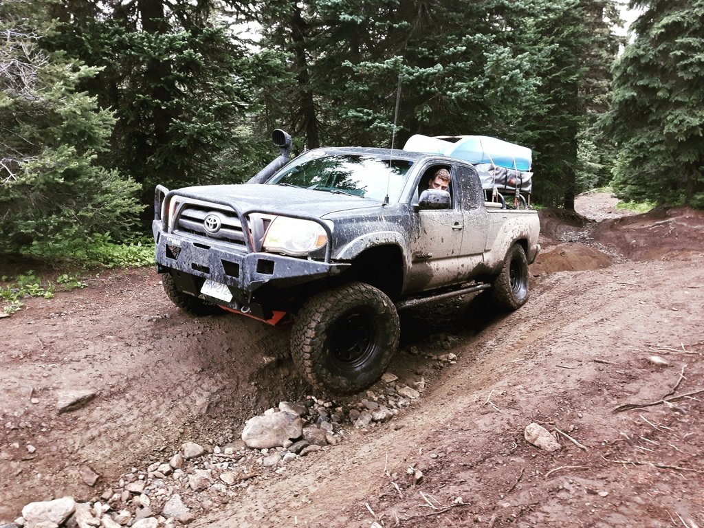

    I was living out of this for 9 months as a raft guide, then got an apartment for the winter to shred. Hoping for a rtt soon lol

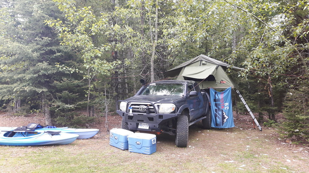

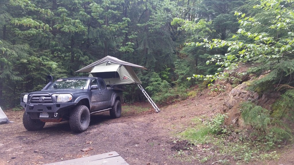

    I has expo mode... forgot about this thread tbh..
    315/75r16 Bfg Ko2
    Rtt
    Plate bumpers
    Skids
    Sliders
    4.88s and lockers
    Snorkel because tires are too big for inner fenders
    hella_tacoma, jagergirll and JPinFL like this.

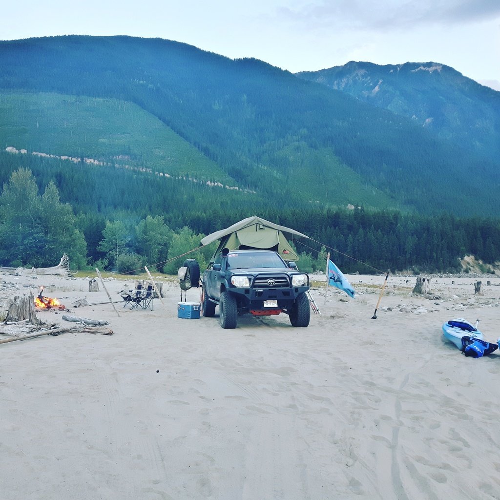

    Normally Im pretty close to sea level, most of my pictures come from the 1500m-3000m elevation range. You don't have to go far in BC to hit the mountains. On some of the more extreme highways I'm in 3rd gear sitting around 4k rpm for a few km to maintain a reasonable speed but that's only when loaded up and travelling the alpine highways, daily driving the truck is fine

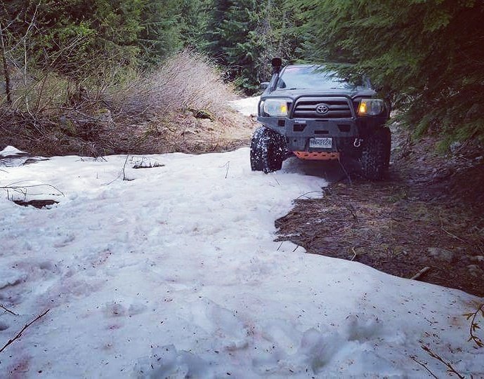

    Since my last post my truck has ubdergone some changes. Boys don't be afraid of weight; If you have a manual transmission that is. My dislike of the auto behind the 2trfe is widely known, so this post will be 5spd specific. If you have auto first off im sorry secondly start saving for a swap. Like I said don't be afraid of weight. If you gear your truck right you can build it pretty much the same as a v6 truck.
    Time for a picture
    This is the most recent pic of my truck as you can see she's a fat bitch.
    Specs
    Armour
    Cruisin off road plate bumpers front and rear (custom for 1" BL and swing out rear)
    3/8ths full skid plate set( when I say full set i mean ifs plate to trans)
    Cruisin off road sliders
    Ricochet aluminum lca skids (they were free)
    Expo AF stuff
    Cruisin Off Road 4" rtt rack keeps the tent level with the high point of the roof
    Prinsu designs access rack
    Airflow snorkel
    Arb 50qt fridge/freezer
    Custom fridge platform in cab
    Tepui kukenam sky rtt
    Oz trail 2.5m awning
    Recovery
    Smittybilt 9500lb winch with steel cable (it was on sale and im too cheap for synthetic)
    Various recovery straps chain and shackles
    Suspension
    King 2.5 coilovers with resis and 14" 700lb coils (worth every penny)
    Ome dakar leafs
    Bcc shackle flip with stock shackle
    Ironman 4x4 foam cell shocks out back
    1" Body lift
    Driveline
    Yukon or nitro 4.88s front and rear I can't remember which brand
    Arb air lockers front and rear
    Rims/tires
    BFG AT KO2 E 315/75R16
    Pro comp series 97 steelies
    Its a lot of shit she weighs in around 5200lbs and still gets 20mpg that's right boys I'm the last person to have to fill up on every trip I go on. That's even after all the weight I've added. So don't be afraid of weight the truck can take it. Build your dream and enjoy
