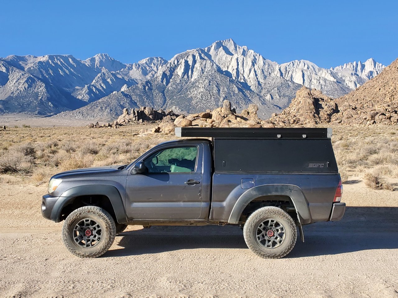

  7. Dec 1, 2022 at 12:53 PM
    #107
    IEsurfer
    IEsurfer Well-Known Member
    Feb 19, 2019
    #283714
    1,932
    Socal
    Not sure if mine counts but here she is
    Dmesser92, rcn, Bikinaz and 3 others like this.
