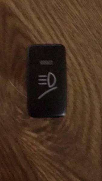

    Kinda new to wiring up off road lighting. I have an nfab street light bar and 4 Hella 500s. I purchased an FJ Cruiser switch part no: PT297-35-072-LS (seen in the pics). Can I wire all 4 lights to the single switch? Would be great if someone can point me to another how-to thread, or walk me through. I've seen others but not quite what I have. Probably operator error using the search function.

    Thanks PCBuilder. Any idea on my specific switch? Across several other forum posts I think I can get it together, but just wanted to be sure.
