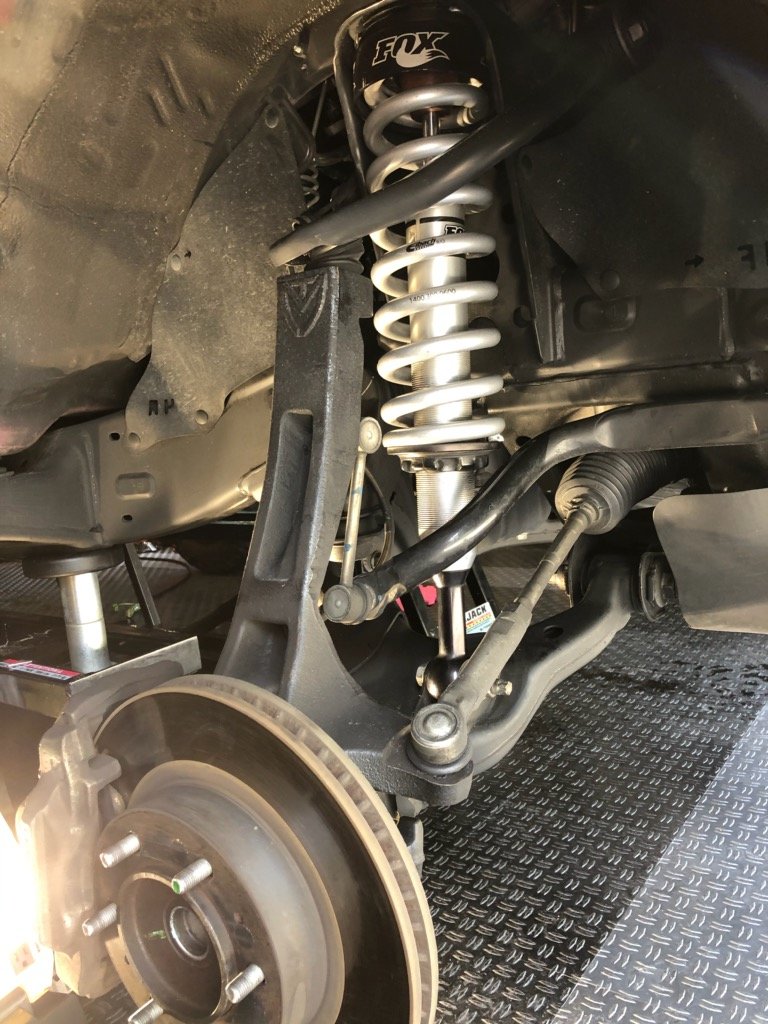

  8. May 17, 2021 at 12:26 PM
    #28
    Taco Senpai
    Taco Senpai Well-Known Member
    May 15, 2017
    #219131
    64
    Taco
    Santa Cruz / Tahoe, CA
    ‘17 MGM OFF-ROAD DCLB
    My suspension set up is almost exactly like yours. Fox coil overs w/ total chaos UCA’s and Fox w/reservoirs and ICON Add a Leaf in rear. Looking at my options to level/raise my front end since I’m looking for more front clearance. Im getting an RSI camper shell also getting a BAMF Hybrid Front bumper so that’s going to add more weight. Called a shop and they said my options were to get a spacer lift or brand new suspension. Would a spindle lift be something that would help?
    EDIT: Still new to the scene. After reading up apparently 4x4 spindle lifts aren’t really a thing. What would you guys recommend?
