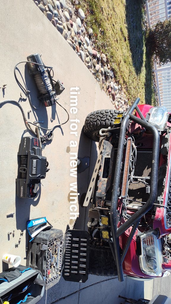

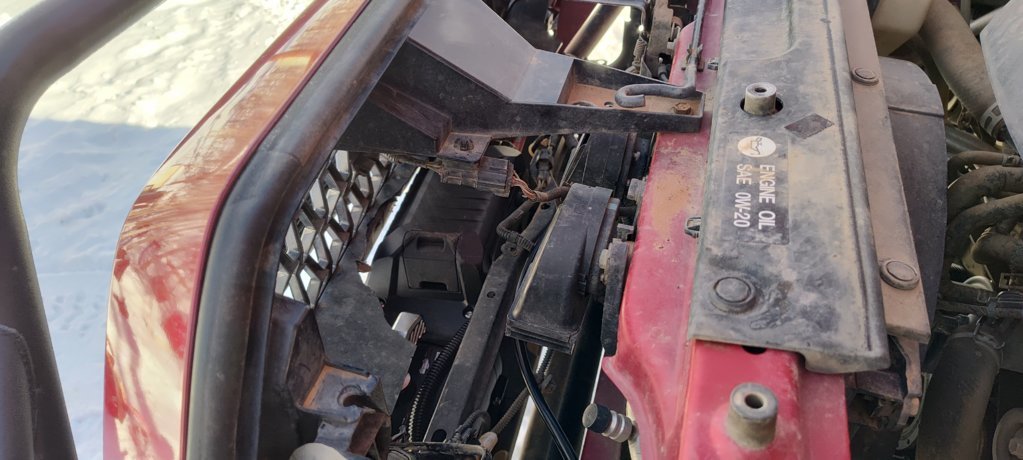

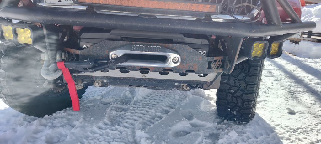

    well it was Black Friday so I got a new winch... I've had my smittybilt 12k on for a year and it's had a rough life... The synthetic rope had snapped at one point so I tied it to the drum and the gears inside of the drum itself we're starting to skip under load. I can't afford a warn and I've heard really good things about the badlands winches. got it for $480 on sale. just what's in the box and installing it seems like it's better quality honestly. we'll see when I have to use it. I found out too that the steel plate the winch bolts to is warped and a part of the cast aluminum winch body was broken. poor thing lol.
    The rear bumper worked out at least... good thick steel. now I can back into trees n shit. :thumbsup:
