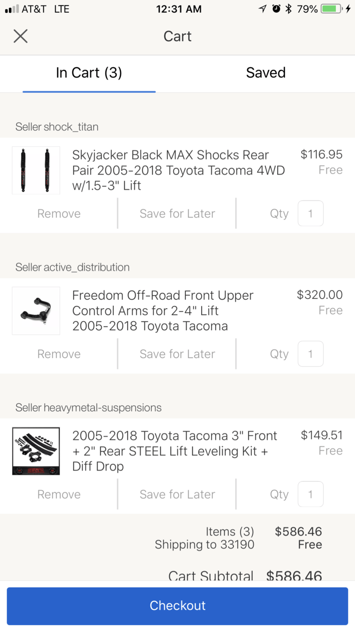

    Ok so since I’m very hardheaded and I really like the looks of a 2.5 to 4 inch lift, which lift do you guys recommend for under $1500?

    Listen, if you plan to do serious off roading then yes get a suspension lift. If you are doing it simply for looks with an occasional stroll on a dirt road, then there is nothing wrong with a leveling/lift kit. I am running 285/70/R17's on a Pro Comp Nitro 3/1 leveling/lift kit. They also did the differential drop that come with the kit. All they had to do is take the mud flaps off. No new UCA's or control arms were needed. As far as power loss running these tires, I don't feel like I lost anything. Yes you see a drop in MPG's. The truck runs and looks fantastic.

    @Neo177 thank you for going straight to the point! I think that’s the route I’m going to take. I thought that the rough country lift was a great deal but I’ve been seen mixed opinions about it on YouTube, so I think the leveling kit is the way to go sinse I don’t think I’m going to be doing any hardcore wheeling with my new truck , at least not for now lol

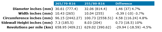

    I was looking at the tire size calculator and that 255 80 17 (33x10x16) looks ideal.....is that what you're running?
    I'd love to go to that size but that's a huge jump from the stock size, did you have to adjust the steering stops?

    I would think that both too tall or too wide would cause rubbing.
    I had 33x10.5 on the stock rims on my old pathfinder and there was no way they would fit w/o a lift. The stock rims were great because the tire stuffed nicely into the wheel well
    The Taco stock tire is 30.6 and the 255/80 is a 32.
    Largest Tacoma Tire Sizes On Stock Suspension
    https://www.tacomaworld.com/threads/largest-tacoma-tire-sizes-on-stock-suspension.67550/
    These are the largest tire sizes that will fit a Tacoma with a stock suspension:
    For 2016+ Tacomas: 265/70/17, 265/75/16 or 265/65/18
