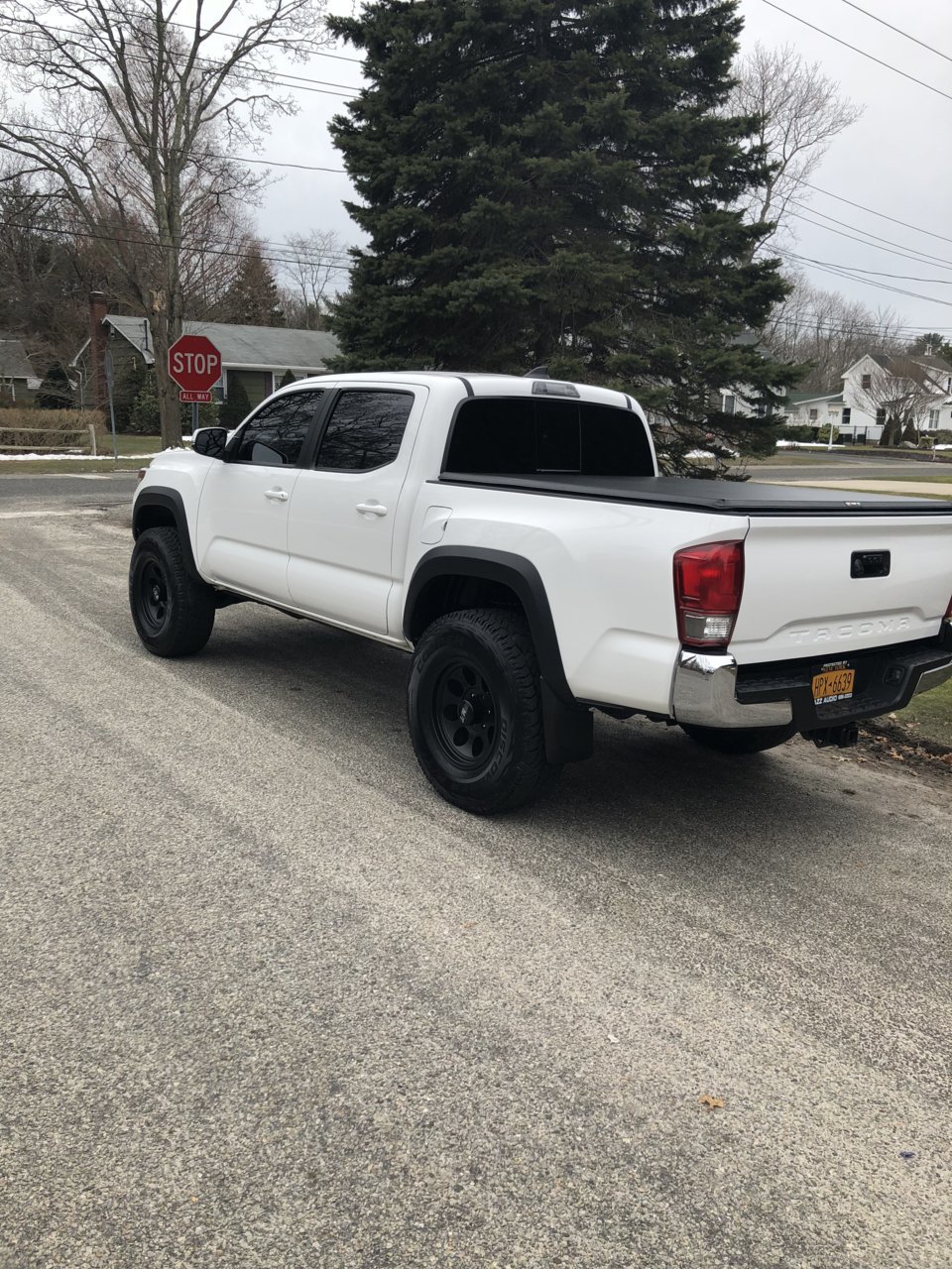

    Only a 1” lift with 285/75r17 but I have -12 offset rims and did a lot of pushing in on the fender liners. A lot. And also I’d reccomend doing 4.88 gears, these tires are 34” and losses a lot of power
