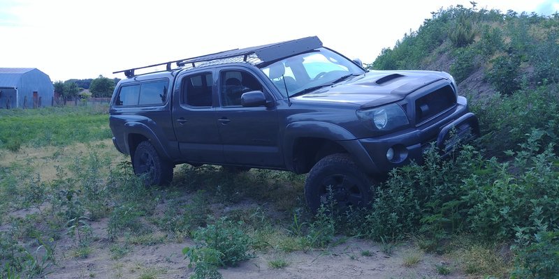

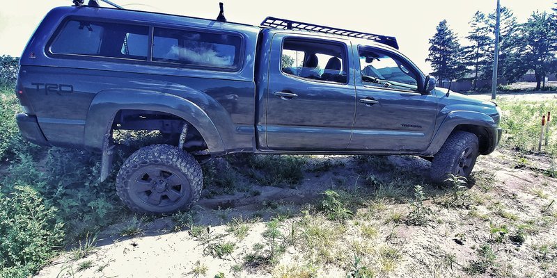

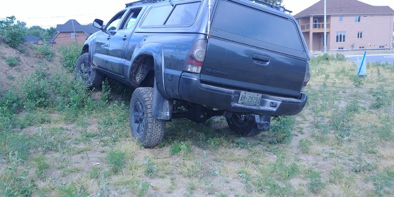

    Feels like the truck will flip before the shocks bottom out.

    You should really do more research before buying shocks (been here, done this). Different companies utilize different tactics for lifting the rear of a truck. Seems you already had the lift and then added the rear shocks. A quick measuring could have saved you right there.
    It took me 30 seconds to figure out that the BDS 4" lift uses a 4" lift block for the rear. The "BDS 4" lift" Fox shocks you have are sized to be used with those blocks. Any shorter on the block, you bottom the shock first. You still would only have 4" up travel but it would be a "safe" 4" of travel that bottoms on the bump stop.
    On another note, you have closer to 6" rear lift. Your shocks collapsed length plus available travel equals 17.5" + 4" + (0.5" shock shaft bump stop) = 22" shock length. My truck sits at 22" shock length with a 6" lift. I use Bilstein 5100 B110 rear shocks and i have timbren bump stops that limit me to right at 5.5" up travel.
