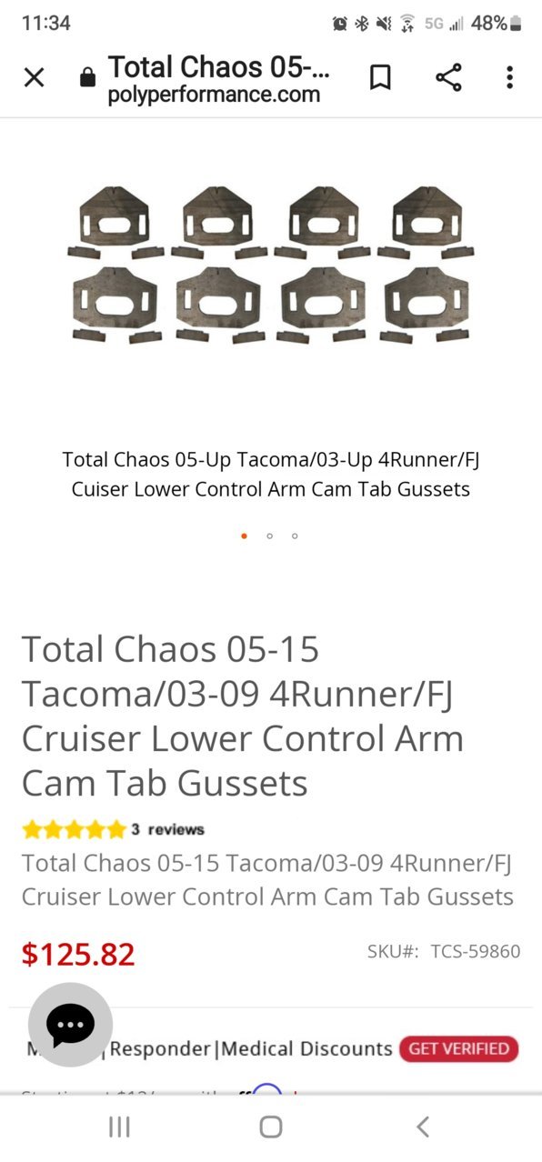

    I decided to just purchase these to fix my alignment problem.

    So just got a quote for welding my total chaos tabs for 800+. And a 4" lift is 1000 now I'm thinking just go with the 4" lift kit. Thinking if I'm gonna spend that much mine as well go with the kit

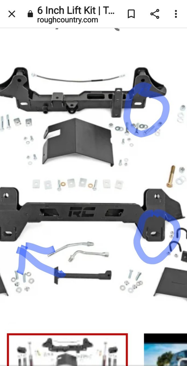

    how does the 4" kit solve the folded over cam tabs? Need those cam tabs in place regardless of what is attaching there

    I'm pretty sure where the drop bracket connects to the existing LCA pivots interfaces on the stock cam tabs. isn't what those square washers are for?
