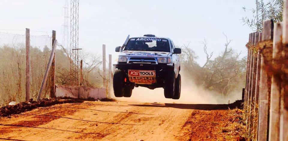

    this is the current truck, 4runner 2000, we are winning the local championship, we have one more race to fight..for the podium.
    some video of the last race https://youtu.be/vNOc1gu_PLU

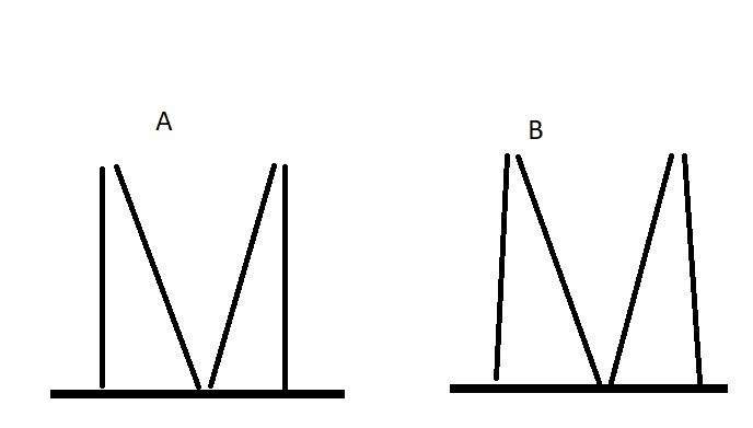

    and I want to make one of these 2 designs
    A: the lower arms are straight to the main frame/chassis
    B: the lower arms are a little angle to the main fame/chasis
    the shock absorbers are above the differential not on the side arms
    it's a high speed truck, and would not know which of these 2 designs would be the best or most recommended, or if it is the same in suspention geometry.
